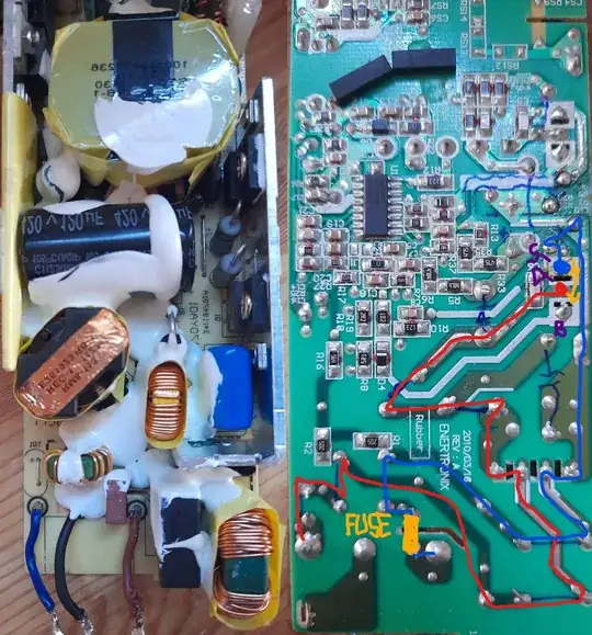

I was playing around disassembling an Asus laptop power brick (19V, 4.74A) and came across this strange arrangement in the circuit, where just after the bridge rectifier, there is a MOSFET (Q1, N channel) that can make a <1 Ohm connection from the + supply (330Vdc) to the negative. This seems to be its only function, and seems it can only result in a blown input fuse. Further down the line as you can see in my rough schematic is of course the switching MOSFET (Q2) feeding the SMPS transformer. Any of you engineers out there, what the heck is the purpose of this ludicrous circuit, if it is there to protect from overvoltage/spikes, wouldn't a MOV be much cheaper than the MOSFET, and wouldn't result in a bricked device after such an incident? I'm quite curious to hear your thoughts! Thanks in advance!
EDIT I kind of lied in the schematic, L4 is actually some kind of transformer, whose secondary goes towards the MCU, it is seen on the board as the yellow tape clad transformer with the wide copper foil strip over top. FYI

    Impossible to be sure without having it in my hands, but Q1 seems to be a part of voltage boosting switch mode regulator which is in use with low (110 V)mains AC voltages. That makes the isolated voltage regulator simpler. –  Aug 25 '21 at 13:39
    If it came with the laptop then it's genuine, if you purchased it then probably not, there are more clones than genuine supplies, they all have similar silkscreen – Voltage Spike Aug 25 '21 at 13:41
    it's possibly for power factor correction with a sine wave controlled PWM dont. Assume ASUS is wrong – Tony Stewart EE75 Aug 25 '21 at 13:43
  • I kind of concur with @user287001 idea about it being a boost converter, boosting the input voltage via L3, L4. Are SMPS that limited in their input voltage range, that the duty cycle can not compensate for 110VAC to 220VAC without a boost circuit? – parkside Aug 25 '21 at 13:51
  • I understand though that a boost PFC circuit is practically a boost converter, adjusting the timings to achieve an improvement in power factor. Does the voltage boost effect get used to compensate for a 110V input, or can the SMPS handle that by directly adjusting its duty cycle? – parkside Aug 25 '21 at 14:05
    There's inserted more info to the question after my guess. The circuit is more complex than it was originally said to be. The comment about voltage boosting if needed to make possible to simplify the actual PSU circuit should be considered only as a guess based on sparse information. The attempt to keep the current taken from the mains AC more sinusoidal (=PF correction for electronic loads) can as well be the original major goal and the possibility to make the actual PSU simpler due normalized input voltage can be only a lucky side product. –  Aug 25 '21 at 14:32

That's the power factor correction circuitry.
The FET Q1 will be switching at high frequency so it won't short rectifed 300V to 0V as there are inductors in the path, most likely L4 is the boost inductor to convert the voltage higher and store it in the bulk capacitor C1.
But yes, obviously if FET Q1 gets permanently turned on, it will short the 300V to 0V when inductors saturate and it will blow the fuse.

  • Ah I had a hankering it might be PFC but didn't recognize the inductor config. Could you just give me a quick rundown which cap and inductor charge/discharge to fix PF, I've numbered them in the schematic. Thanks! – parkside Aug 25 '21 at 13:37

    @parkside oh, misread. Is it not C1? (L3/C4 looks like filtering, and it's before the diode anyway) – user253751 Aug 25 '21 at 14:22
    C1 buffers the voltage going into the SMPS transformer, L4 is the inductor participating in the boost converter circuit that acts as PFC. – parkside Aug 25 '21 at 15:28

As the other answer points out this looks like active power factor correction.
Power factor is the ratio of real power (short-term average rate of net energy transfer) divided by apparent power (RMS voltage times RMS current). The maximum possible power factor is 1 and is achived when the current waveform is exactly proportional to and in phase with the voltage waveform.
note that a lot of sources will talk about power factor in terms of phase, that worldview makes sense when you are discussing AC motors but doesn't really make sense when discussing rectifier-capacitor circuits.
Traditionally in a switched mode power supply you had a rectifier immediately followed by a large "primary capacitor". The problem with this setup is it's power factor is awful, current is drawn in small spikes close to the peak of the AC waveform and no current is drawn at other times.
The power factor can be improved somewhat by adding a large inductor in series with the input, this reduces the rate of change of current and hence spreads the spikes of current out a bit, it is known as "passive PFC".
Active PFC like your power supply has takes things a step further, it adds a boost converter between the rectifier and the main primary capacitor. In your schematic this boost converter is formed by Q1, L4 and the diode above Q1.
When Q1 is turned on charge builds in L4, when it is turned off L4 discharges into the capacitor. This allows current to be drawn from the mains in a controlled manner throughout the cycle and hence allows a very high power factor to be achieved. A power factor of 0.99 is often claimed for power supplies with active power factor correction.
It also allows a consistent voltage on the primary capacitor to be maintained regardless of line voltage changes. This is useful when implementing a universal-voltage power supply. The energy stored in a a capacitor depends on the square of voltage, so a 3x variation* in voltage translates to a 9x variation in stored energy.
