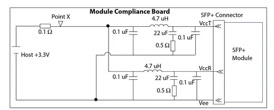

D.17 POWER SUPPLY TESTING METHODOLOGY The reference power supply filter shown in Figure 56 is provided for module testing, including power supply tolerance testing. This filter will meet the noise filtering requirements in most host systems. Other filtering implementations or local regulation may be used to meet the power noise output requirements described in 2.8.2 and 2.8.3.
For each Vcc, the sum of the equivalent series resistances of the 4.7uH in- ductor, the 22uF capacitor and the damping resistor is 0.5 Ω. This resistance is desirable in actual host filters as well as in the reference filter; however, any voltage drop across a filter network on the host is counted against the host VccT and VccR accuracy specification in Table 8. reference LC filter

If I'm reading it correctly, to determine the PSU noise, first, your power supply preferably uses the reference LC filter given. Then you take a measurement at the PSU output, at the SFP+ socket. Finally you divide the results by the LC filter's transfer function H(f) to "de-embed" that filter and reconstruct the power supply noise voltage before the reference filter.
Thus, you're measure the noise after the filter, then remove the filter, What is the motivation of the convoluted measurement methodology here?
A friend suggested that it's because all SFP+ modules are connected together, measuring it after the filter allows can to see the coupled noise from other modules. But it's not the case. Each SFP+ modules have two rails, each has its own LC filter, and all ports are also filtered separately (for example, this two-port FPGA reference design clearly shows 4 sets of filters, see page 22, 23).
My best guess is that at the point wbich the power comes out at the VRM, the noise may be acceptable. But later, when it passes through the LC filter, then routed all over the board, more noise can be unintentionally coupled into the rail only after the LC filter. The approach of measuring and de-embed allows one to see these additional noises, hence giving a more accurate measurements.

Other measurement methods could be used, e.g. a measurement at a point inside the host, with appropriate consideration to any difference between the reference filter and a host’s actual filter.
What exactly does it mean by "with appropriate consideration to any difference between the reference filter and a host’s actual filter"? For example, if I'm using a different filter topology for my power supply, do I have to characterize the frequency response of my filter and use my own transfer function in place of the reference filter, or what?

I don’t know if I can explain it any better than the spec. But this is my understanding.
Each component in this filter serves a purpose for noise attenuation in both directions. The test method removes ambiguity yet serves to satisfy all requirements under any condition within power limits, 1W & 1.5W @ 3.3V. There is leeway for variations in test methods.
Noise is created and suppressed in both directions and a test method was defined to validate the effective improvements of the filter to ensure it does not contribute to more error from load regulation or resonant amplification. The filter also serves to add some isolation between shared loads with the 100 mohm series R to X.
At least they don’t define a profile for all scattering parameters, but this helps you understand the interaction between burst load currents and supply loop margin and output impedance…. ( I digress )
Removing the filter increases reduces the attenuation in both directions to prove the effectiveness in both directions. The load regulation error at DC is just the ratio source to load resistance in % so the 0.1 Ohm before X adds DC load regulation error but reduces the slew rate of disturbance on the host regulator output.
The transfer function of attenuating noise in both directions can be verified with a sweep generator at point X with a low impedance source and a dummy load is used (8 or 15 ohms or 1.5W or 1W max) module loads for a linear voltage ratio.
The total error budget is split up into separate quantities with this method. yet allows for various test methods to validate forward and reverse transfer function.
