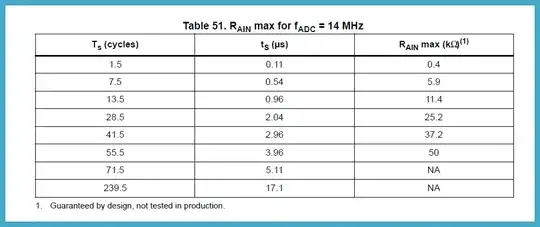

EDIT: here are some timings according to STM32F0 datasheet, ADC characteristics:
STM32 ADC characteristics and timings
Which many of them are nearly fixed for some certain setups. the sampling time which is marked, is configured by user. based on this configuration the maximum Rain is provided: Maximum Rain for various sampling times
the sampling times seem to be fixed sufficiently as long as you don't use that dedicated 14MHz ADC clock.
