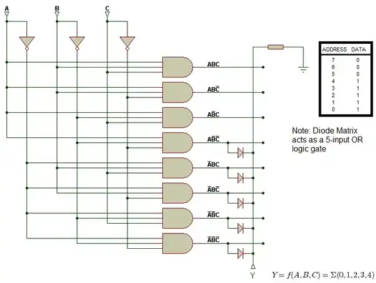

A read-only memory (ROM) is a logic circuit that can generate all of the possible minterms of its inputs.
Eight-word by one-bit read-only memory
So, these are the characteristics of the ROM:
Input products are hard-wired and include all possible minterms. Output summation circuitry is programmable.

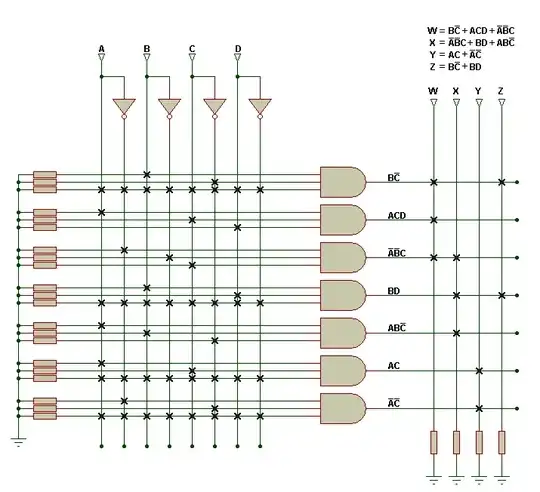

A field programmable logic array (FPLA) only those minterms that are needed are generated. Also, each is generated only once, even though it may appear multiple times in the output expressions.
FPLA implementation of logical functions
So, these are the characteristics of the FPLA:
Input product circuitry is programmable. Output summation circuitry is programmable.
A programmable array logic (PAL) has the input circuitry similar to that of the FPLA. However, the output circuitry includes hardwired OR logic and is not programmable.
PAL implementation of logic functions
So, these are the characteristics of the PAL:
Input product circuitry is programmable. Output summation circuitry is hardwired.
