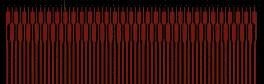

I want to design the even/odd pattern of FFC (flexible flat cable) in Altium. I don't know the exact term used to describe it, but the recommended drawing of this FFC from its target connector's manufacturer is here:
FFC manufacturer's drawing
Please note that I am asking for guidance in designing the yellow highlighted contacts. I have no idea how to make them in that shape.... Your help is much appreciated.

    Take a look at [here](https://www.altium.com/documentation/altium-designer/working-with-custom-pad-shapes-ad?version=19.1). – Rohat Kılıç Aug 18 '21 at 13:18
Took @RohatKılıç's advice after finding nothing else helpful. The end result: Here
