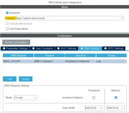

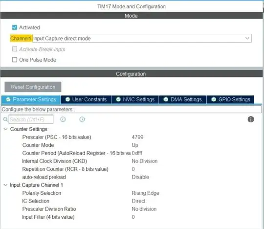

Method - Input Capture:
I enable IC1 (Input Capture 1)
I enable IC0 (Input Capture 0)
Then I start IC with DMA.

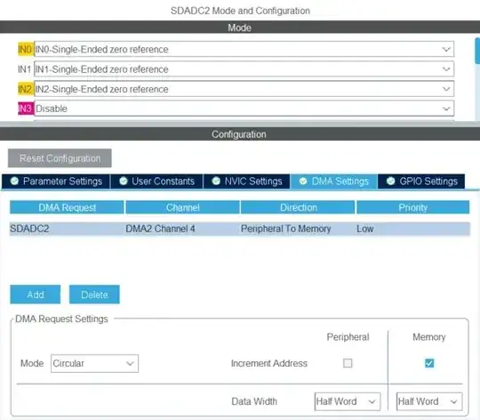

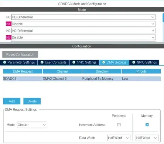

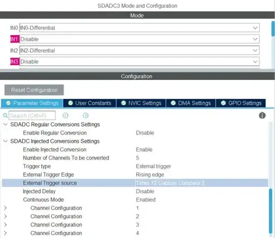

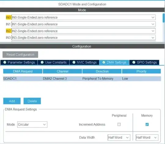

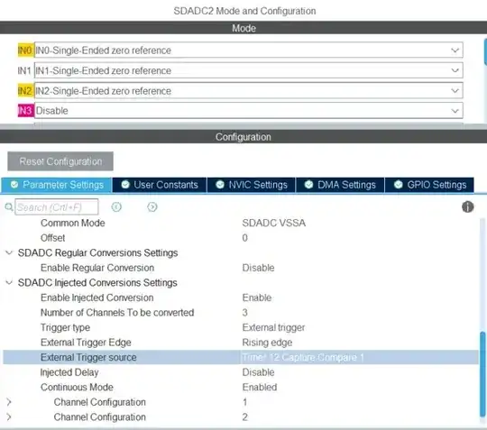

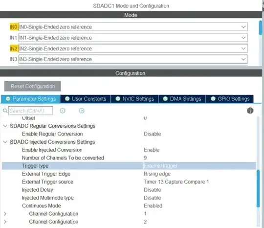

Method - Sigma Delta ADC
I enable Sigma Delta ADC 1
Sigma Delta ADC 2
Sigma Delta ADC 3

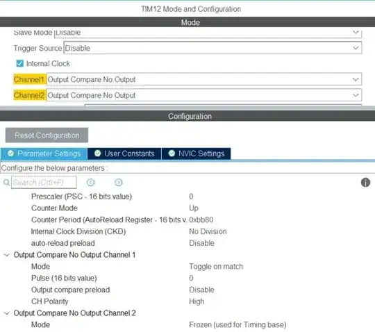

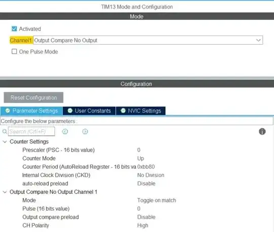

And for timer 12 and timer 13
Results - Input Capture
When I call to read the arrays input_capture0, input_capture1 then the DMA has only filled the arrays 1 time only. Only the first element has a value, the rest of the elements has 0 value. I try to pulse 3.3V onto the Input Capture pin, but it only react once.

Result - Sigma Delta ADC
When I try to read the arrays SDADC1_Single, SDADC2_Single, SDADC3_Differential, only the first element has a value, the rest of the elements has 0 values.

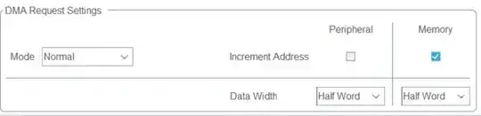

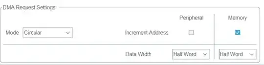

If I enable change Circular Mode to
Normal Mode
It will give me the same results. The first element get a value, the rest of the elements are zero.

  • @ScottSeidman The clock is configured correctly. There is no issues with Sigma Delta ADC if I'm using interrupts with the same TIM12 and TIM13 trigger. No problem there. Only when I'm using DMA. – euraad Aug 18 '21 at 14:03
