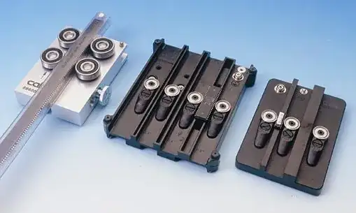

No changes are required. DIPS are spread to allow straightening either manually or in auto-insertion machines.
Here’s one clever tool that keeps the IC’s in their ESD protected tube.
