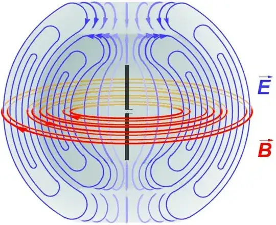

How does the field actually leaving an antenna look? I am going to use one of the simplest again, the electric dipole.
From wikipedia.en.wikipedia.org/wiki/File:Felder_um_Dipol.jpg From: http://en.wikipedia.org/wiki/File:Felder_um_Dipol.jpg
So, when you have a wave in free space, it is propagating without boundaries. When you have a wave in a cable, it is normally bound between the conductors. The Coax cable being an example of a bounded TEM mode waveguide. An antennas job is to match and couple the wave in the waveguide to the impedance of free space and help it radiate. As you look at an electric dipole you can see that the wave is coupling into this structure which will smoothly couple into space as the wires draw apart. That is, at minimum, a way to think about it.
I have also made a point of saying electric dipole as I have spoken and shown examples. An interesting thing to think about is how a loop antenna works. A Magnetic Dipole will have the same field pattern as the electric dipole you have seen, but switching the Electric field lines with the magnetic and vice versa. The issue is that the curving magnetic field there will not be nearly as large a loop as an electric half dipole, and getting to that point is quite hard.
