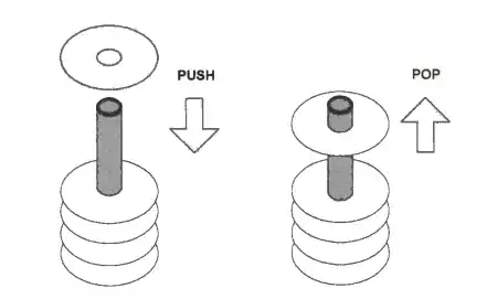

Below is an illustration of the stack concept:
Enter image description here
I have read many times about the stack pointer and how some variables are stored in SRAM on a stack.
Many tutorials explain how it works, but not why this concept exist at all.
Imagine I am the program and I want to store my cup, my watch and my hat in my room. Why would I store them on top of each other instead of putting them in random places in my room?
Program can reach the data as long as it has its address. But if the stack pointer puts x on the top y. How will it reach y without removing x then? So to me a stack must make things (data access) even harder.
Can you give a very simple example with registers or assembly code or C code to illustrate the benefit of this stacking concept, namely "Last in, first out" (LIFO)?

Program can reach the data as long as it has its address. But if stack pointer puts x on the top y. How will it reach y without removing x then? So to me stack must make things(data access) even harder.
Well, it does make accesses "back up the stack" more difficult; generally when one needs to do this there will be a sequence of pointers on the stack that allow you to go back, routine by routine, finding the "stack frame" of each so you can access its data. (Thus, you could look up the hat you stored, the hat stored by the routine that called you, a different hat stored by the routine that called it, and so on.) This is not an unusual technique, but explaining it in detail is probably beyond the scope of the answer you're looking for.
cjs
  • 863
It doesn't have to. These variables are temporarily stored on the stack in the exact order (push), then they are retrieved back in the reverse order.
At each function call, interrupt,... the processor pushes the registers on the stack, the most important among them is the PC - program counter, is the last position in the program before it jumps to another position in the program memory. When the function is called, then it jumps to another position, it processes the function and then in the reverse order it pops the registers, lastly the PC and it starts to execute where it was interrupted.
Marko Buršič
  • 23,562
The stack is a very simple temporary storage mechanism. To extend your analogy, it's the entry table of your room (that you pull out of the wall). It's already there, you know where it is and how to reference it. So you stack your item(s) there. When you are done, you take your stuff and put the table away, giving you your space back.
If you wanted to place them in random places, you'd first need to allocate that space (either in BCC or the heap), like building a table to put your hat on. Then (in the case of heap storage) when you remove your hat and leave the room, you need to deconstruct the table before you leave. Otherwise when you come into your room again and build a table for your hat you'll eventually run out of room for tables. That's called a memory leak!
If you want to use a permanent variable (from BCC) that would be like making one table per item, and they are always there taking up space, whether you used them or not.
Not a problem! There are other registers (a shelf in the room?) that the stack pointer is copied to (SPc). Then the stack pointer is added to in order to create the temporary space on the stack. So SP+=1 to store X. Then SP+=1 again to store Y. The programmer can still access the memory pointed to by SPc+1. Of course the more efficient way is to do SPc+2 and then put X at SPc+1 and Y at SPc+2, but that's another story.
Aaron
  • 7,274
  • 30
You wouldn't.
But you could put your overcoat, hoodie and t-shirt in a stack, in that order, because you only ever need the top one of those, and to make use of the bottom one, you need to wear the others first.
Or, if you're a recursive function, and you only ever need the variables of the most recent instance of the function, putting them in a stack and just looking at the top one always gives the most recent instance. Usually, a general purpose programming environment would generalize that for all function calls, so it doesn't need to analyze the whole call tree to know which ones can be called from each other. That gives smaller memory footprint than allocating a distinct area for each function does.
None of this is probably specific to embedded programming, stacks come up in algorithms elsewhere too.
ilkkachu
  • 1,067
There are some very detailed answers already, but I think it might be helpful to focus on one of the most important.
A stack helps you write re-entrant code, that is, subroutines that can be called again before they finish. You need these for recursive algorithms, and sometimes for event handlers.
If you try to write one of these without a stack, one problem you have is how to return from the subroutine and resume execution. You need to save the original state of the program somewhere, and if the subroutine gets called again, it has to put the new information someplace else without overwriting the other information.
Another problem you get is when a subroutine needs local temporary data. If the same function gets called recursively, each call needs its own local data that won’t overwrite the data from earlier calls.
A stack is not the only way to do this, but it’s the solution everyone ended up using because it’s so simple: you allocate a new block of memory by subtracting the number of bytes you need from the stack pointer. Allocating memory from a heap is much slower and more complicated. And then, programs used the stack so often, most CPUs built support for it into their instruction sets.
Davislor
  • 181
When you get and go into your room you allocate three boxes. You stack them on their sides so that you can see the open end of each box. You put your hat, watch and cup in the boxes, one item each. That is the key to having the stack be useful for general purpose computing. You can have random access to your allocated stack for the duration of the time you are in your room. When you move out you free up those boxes and return them to the pile of empty stack boxes.
You get your room, you go allocate a box, set it such that the open side faces you (is not up or down but to the side). Put your cup in it. You go off and allocate another box, set it on top of the first stack box, also open end facing you, put your hat in it. Repeat until you have the desired items stored in stack boxes. For the duration of your stay you can randomly access (any item in any order) any of the times from your stack. When you move out you empty and return one box at a time from the owner of the stack boxes.
True, stacking them such that the open end is covered by the next box on the stack and you can only access the item on the top of the stack does not work nor make sense for general purpose computing (with high level, compiled, programming languages). There is a use case that you will find in some processors. Return addresses for function calls. You nest your function calls and you cant cheat, you have to return from one before you can return from the next higher one. So you can use a stack in that way such that you can only at any time see the contents of the item on the top of the stack and all the others are blocked from view.
