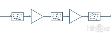

Second on the IF filter/amplifier, shown in block diagram here : block diagram
The purpose of a bandpass filter is to extract a frequential component at ω (reflected frequency) minus ω0 (LO frequency), while filtering upper components from the diode mixer and lower componants as DC or 50Hz. But there are two things I don't understand here : why two stages of bandpass filter / amplifier ? And why finally a low pass filter ? Aren't all upper frequency already filtered ?

  • I'm not an expert by any means but I think this sort of thing is pretty common in RF signal conditioning. The signal coming in may be very weak and the first filter may just do the minimal amount of conditioning so it fits the input of the first amplifier. This is followed by other stages to try and shape the overall frequency response in ways you can't do with a single filter element. – Guy Sirton Feb 14 '13 at 02:17
  • Joan, thanks for your answer. But unfortunately, I don't have any access to datasheets... In this project, we only know block-diagrams or have pics of components. Guy Sirton, thanks for your help. According to you, what is the purpose of the low pass filter ? – C_Computing Feb 14 '13 at 13:19

With amplifiers right at the output of the mixer, your noise is dependent on your bandwidth (\$kTBF\$ where B is filter bandwidth, F is noise figure etc...), so in order to not blast your receiver with a bunch of noise or saturate the amplifier, you would want to use a BPF to only select the bandwidth within your range, which also serves the purpose of eliminating spurious signals from the mixer.
I'm not sure on the second amplifier, it may be there just to provide more gain (cheaper components) and you need another BPF to filter again before that amplifier so you again don't amplify a bunch of noise. Your LPF there at the end is probably used to eliminate the IF mixing component. Your output has a Doppler frequency component and an IF frequency component, where your Doppler component is order(s) of magnitudes smaller than the IF frequency.
You are correct in saying the your mixer output would be your signal frequency minus your LO frequency, but that just gives you your IF frequency. Your information is stored in a different component, the Doppler frequency. It would be helpful to know more about your system (such as LO frequencies and the specs of the components).

The final LPF may be intended as an antialiasing filter for an ADC that follows it. Even if you don't expect a lot of higher-frequency content in front of an ADC, it's a good idea to include a lowpass filter to keep the ADC from seeing broadband noise from the amplifiers.
