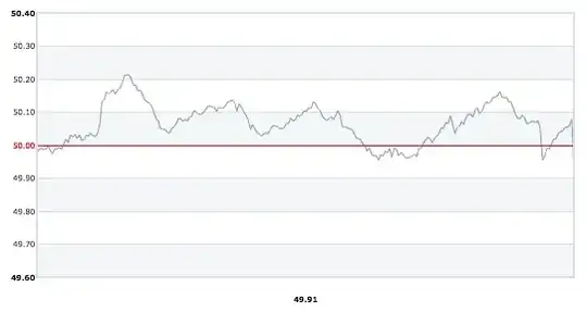

  • I did a quick two-wires-in-my-multimeter-frequency-test during some 15 minutes. Nowhere near long term and it shows couple of transients, but it gives a nice impression of what is going on with the Dutch grid: http://i.stack.imgur.com/GS58e.png – jippie Feb 13 '13 at 15:18
