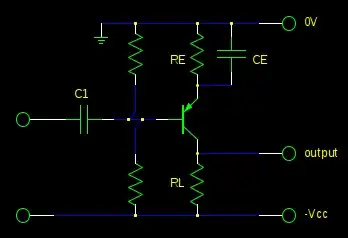

Any amplifier that can be made with an NPN BJT can also be made with a PNP. Whether its inverting or not really depends on how the output is interpreted. More on that later.
To convert this NPN common-emitter amplifier to a PNP common-emitter amplifier, just mirror the entire thing except for the supply voltages top-for-bottom:
PNP common emitter amplifier
Equivalently, you can just swap the NPN transistor for a PNP transistor, and replace +Vcc with -Vcc. However, the convention is to draw schematics with higher voltages at the top, so the resulting schematic would look a bit funny.
Remember that voltages are relative. The only important thing with a PNP common emitter amplifier is that the emitter is at a higher voltage than the other terminals, the base is approximately 0.6V lower than the emitter, and the collector will be lower than the emitter, with how much lower controlled by the base current and load.

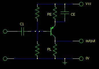

If we call the highest voltage in the circuit "ground", then we can have negative voltages. Or, we can call the lowest voltage "ground" and have positive voltages. We can even pick a voltage in the middle and have both. Or, we can ignore ground altogether and talk about the voltage "drop" or "across" a component or between any two points in the circuit.
This is the same circuit, just with a different notion of "ground", which is completely irrelevant to the operation of the circuit, only our discussion of it:
with ground at top
Really, the terminal labeled "output" is a voltage somewhere between the other two terminals. Is it inverting? Well, are we considering the signal to be the output relative to the higher voltage at the top, or the lower voltage at the bottom?

  • 1) The output signal is coming out underneath the PNP, above RL, correct? 2) The reason I was clear about +Vcc and 0V is that I'm using an Arduino where GND and +5v are clearly labeled, where calling +5v '0v' and GND '-5v' seems odd; though I realize conceptually they represent the same thing. 3) What software did you use to make the diagrams? 4) Thank you! – Ehryk Feb 12 '13 at 13:12
  • @Ehryk forget about the names. The electricity can't see those labels anyway. See edits. Schematics were drawn with gschem. – Phil Frost Feb 12 '13 at 13:48
  • So both PNP and NPN transistors in this design are non-inverting with respect to the higher voltage potential/emitter side, and inverting with respect to the lower voltage potential/collector side? – Ehryk Feb 12 '13 at 15:05
  • @Ehryk I don't know how to answer that, because on an NPN common emitter amplifier, the emitter is on the lower voltage side. So, the statement "higher voltage potential/emitter side" is self-inconsistent when considering both PNP and NPN common-emitter amplifiers. If you always call the lower voltage "ground", and you consider both the input and outputs relative to ground, then NPN and PNP common-emitter amplifiers are inverting. – Phil Frost Feb 12 '13 at 15:12
    @Ehryk my advice would be to become comfortable with how this circuit works. Ask a new question with a finer point if you need help. Once you understand how the circuit works, the invertingness will be easy to figure out. – Phil Frost Feb 12 '13 at 15:15
  • I was considering the higher voltage potential 'ground' with the PNP transistor. My mistake, would this be correct then: PNP and NPN transistors are non-inverting with respect to the higher voltage potential, and inverting with respect to the lower voltage potential? – Ehryk Feb 12 '13 at 15:18
  • @Ehryk In a common-emitter configuration, and with the input referenced to the lower potential, yes. If it's not clear to you why, you really should strive to understand more completely _why_ the circuit is an amplifier, and _how_ it works. – Phil Frost Feb 12 '13 at 15:22
    @PhilFrost A common emitter circuit does not necessarily have its emitter on the lower voltage side, that is only true when using a NPN transistor. All "common emitter" tells us is that both input and output signals share the emitter as a reference. Strictly speaking, a common emitter doesn't have an \$\text{R}_\text{E}\$ – jippie Feb 12 '13 at 18:38
