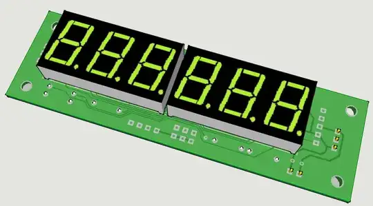

6-digit 7-segment displays are not very common: Single, 2, 3 and 4 digit modules are much more easily sourced.
Here is one 6-digit 7-segment intelligent display module that can be bought as a kit or fully built - it actually consists of two 3-digit displays on a single PCB, with a serial interface:
It uses a serial input, 9600 baud, 8 data bits, 1 start bit, 1 stop bit and no parity.
