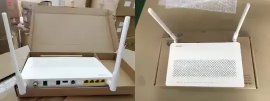

Let´s suppose We have the following Optical Network Terminal :
According to datasheet, the receiver sensitivity is : -27 dBm

1 ) If we reach that limit (-27 dBm) : Does it affect the conectivity speed ?. For example If we pay conectivity of 300 Mbps this speed will down to 50 Mbps, or 30Mbps or 10Mbps ? Or just It cause intermitent conectivity ?

  1. Below -27 dBm, it stops working. That's the definition of "sensitivity". Of course, if you're at -26 dBm, your mutual information is not great, so you might experience lower data rate. How specifically that is implemented depends completely on the communication standard and the actual device.
  2. Yes. That is the definition of dBm. What's the question?
