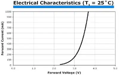

The following is a current voltage graph of a typical LED. Unlike resistors, which have a linear voltage current relationship, LEDs have an exponential relationship. Which means that after a certain voltage (operation voltage is typically round 2V for small LEDs), the current increases greatly for just a small further increase in voltage.
High current, in itself, for most electronic components is not a problem including LEDs. The problem is the heat .i.e. the component generates a lot of power which it cannot lose to the air around it fast enough, and starts to get hot. For the first few moments the temperature is still low and everything is fine. But if the condition continues the temperature gets high enough to fry the component.
The way we solve this is as Olin mentioned, is to solve by assuming that the voltage drop on the LED is the operation voltage and it is consuming its operating current. The remaining voltage we want to lose to a resistor at this current.
