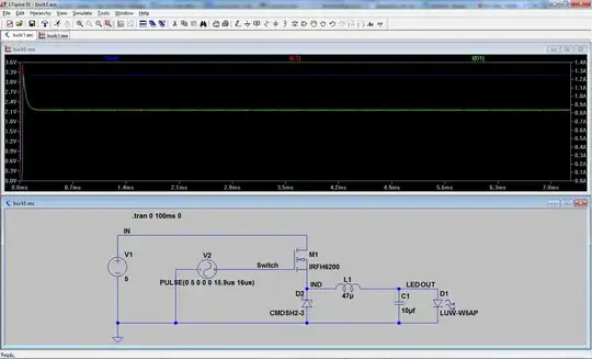

I simulated the converter in LTSpice before building it, though the parts aren't the exact same part numbers as in LTSpice, so I'm sure many of the important values are somewhat different.

LTSpice simulation
The LTSpice simulation shows it supplying around 850ma with a 99% duty cycle, but with different parts.

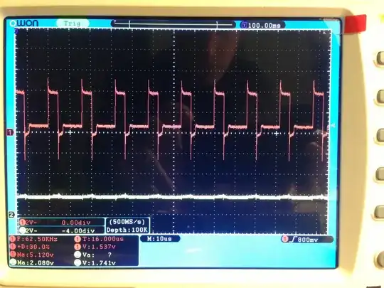

oscilloscope traces, 30% duty cycle
My circuit, with a 30% duty cycle. Channel 1 is the gate pin of the MOSFET, channel 2 is the output to the LED. The ripple is fairly low, so I think that means it's running in continuous mode.

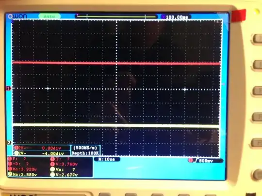

oscilloscope traces, 100% duty cycle
My circuit again, with a 100% duty cycle. At this point my bench supply says it's supplying 70ma, at 5.0V. If I turn up the voltage to 12V, I get around 185ma out of it.

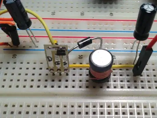

breadboarded circuit
The FET is an N-channel FET I happened to have around. Both capacitors are 10uf. The diode is a 1N4001 (not ideal, I know.) The inductor is a 47uh inductor I happened to have around. I don't know anything else about it.

Looking at the waveforms, the top trace of the first picture doesn't look like the gate voltage. It looks like the source or cathode of D2. Note that when the switch turns off and voltage goes low, it goes below ground like you would expect the diode cathode to do. Then note that about 2uSec later it jumps up to what appears to be the voltage across C1, like you would expect if the L1 ran out of energy and became discontinuous. That's probably about the right amount of time for an L1 of only 47uH. It should also ring at that time, but there is enough loss somewhere in the circuit (L1, D1, or maybe even M1) to dampen it out.
It is not clear how you are controlling the current, but driving a LED with constant current, you should not need C1. Just keep the ripple reasonable in the inductor and get constant current in the LED. It would also be easier to compensate the loop without C1. Also, there are parts that provide PWM control for LEDs, like this one (which is the cheapest example at Digikey).

To find out what's limiting the current, turn the duty cycle full on and look for voltage drops across each component. If you have 5V on the input, that 5V has to be dropping across something as current flows from the positive terminal of the source back to its negative terminal. That something is what's limiting your current. The obvious contenders are the FET, the choke, the input supply, and the load itself. None of those components look like they should have those kinds of drops across them, based on the part numbers in your schematic, but obviously something's not adding up.

I think your magnetics is very small. With power inductors, inductance is not everything. Check its series resistance and the maximum current it can support.
