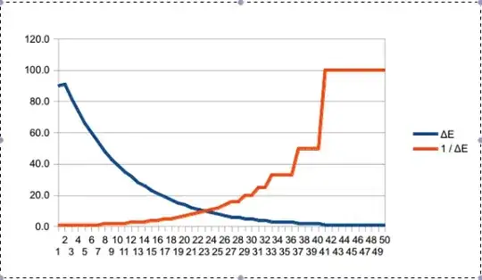

The initial relationship successfully ramps up the PWM output based on the lack of change in the motor. See the graph below for the sample output.
This approach makes since for the situation where the non-aggressive PID stalled. However, it has the unfortunate (and obvious) issue that when the non-aggressive PID is capable of achieving the setpoint and attempts to slow, the stalled_pwm_output ramps up. This ramp up causes a large overshoot when traveling to a non-loaded position.
1/ΔE vs ΔE

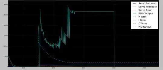

Stalled PWM Output Stalled PWM Output
Note that in the stalled PWM output graph the sudden PWM drop at ~3400 is a built in safety feature activated because the motor was unable to reach position within a given time.
