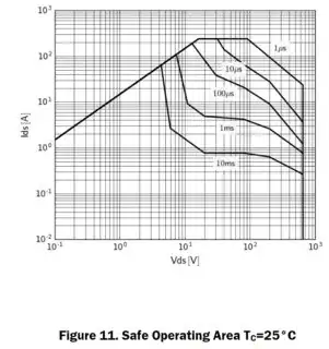

enter image description here Above is a screenshot of the SOA graph from the GAN041-WSB350 datasheet.
When I saw this, I immediately got very curious, because I'm used to seeing SOA graphs where all the lines on the top right are parallel and either straight lines (for devices that don't suffer from second breakdown) or with a single bend (for devices that have second breakdown). I've certainly never seen concave portions of the graph!

I would assume it's something to do with it being a GaN device, but it's clearly more than just the fact that it's a wide-bandgap semiconductor--the first of my examples of a normal-looking SOA graph is a SiC part, and that looks identical to any old silicon MOSFET's SOA. I know GaN parts typically can't handle avalanche at all; is that one of the limiting factors making the odd shapes? Even if so, what are all the other limiting factors? This graph just looks so bizarre.

  • I have a feeling that fig 11 in the GaN device might be a decent clue. On the other hand, I never believe pure straight line graphs for regular MOSFETs because of thermal runaway at lower gate-source voltages. – Andy aka Jun 25 '21 at 09:14
    A GaN device is comprised of an enhancement MOSFET and a depletion GaN part - I wonder if that causes the unusual SOA. – Kevin White Jun 27 '21 at 01:37

Another interesting fact the SOA for other GaNs look similar (this GaN part has almost all or very similar specs to the one in the OP) and also has that weird SOA curve:
https://www.transphormusa.com/wp-content/uploads/2020/02/tp65h035wsqa_v1-1.pdf
This means the problem is most likely related the properties of a GaN, but what?

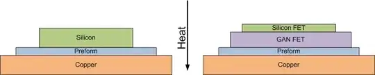

The GaN is cascoded, so it is actually two FETs
Source: https://assets.nexperia.com/documents/data-sheet/GAN041-650WSB.pdf
For a single FET
Both the cascode\silicon FET and the GAN FET generate heat with their bulk resistivity, and this heat has to move toward the gate.
The heat from the silicon FET has more material that it needs to pass through to reach the heatsink (the epoxy is not as good at conducting heat). This results in two slopes of the SOA graph. The silicon cascode FET will also likely be one of the hottest areas in the device. (which makes me wonder if cascoded GaN isn't really that competitive as a switching device as the SiC device listed in this question has no such limits. It also makes me wonder if there aren't ways to improve GaN.
However, I did find some SiC FETS that (are advertised as) are cascoded, but they have no weird SOA (That device is here: https://unitedsic.com/datasheets/DS_UJ3C120040K3S.pdf), I didn't find the construction of that device, but in the end I think it's construction more than anything that determines the SOA along with the thermal stackup.

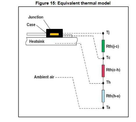

enter image description here Source: https://www.st.com/resource/en/application_note/dm00241971-thermal-effects-and-junction-temperature-evaluation-of-power-mosfets-stmicroelectronics.pdf
The link above is a really good read if you ever need to do modeling on FET thermal internals.
