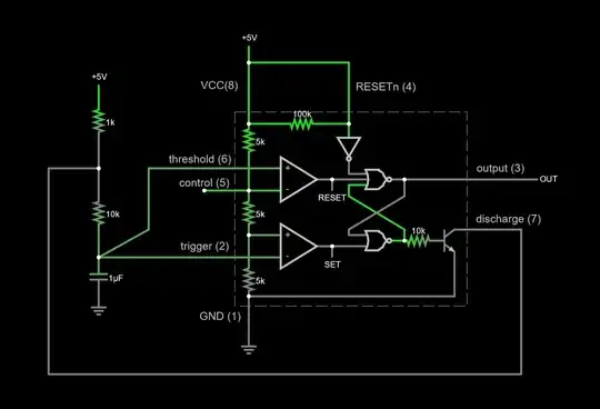

As a way of explaining how the 555 works, here's a simulation showing its internals (simulate it here):
What's supposed to happen is the capacitor charges up, when its voltage reaches 2/3 VCC the upper comparator fires and resets the latch, starting the process of discharging the cap. When the cap voltage reaches 1/3 VCC, the latch is set by the lower comparator, stopping the discharge and allowing the cap voltage to rise again.
So as it oscillates, the cap voltage should be ramping between 1/3 and 2/3 VCC.
