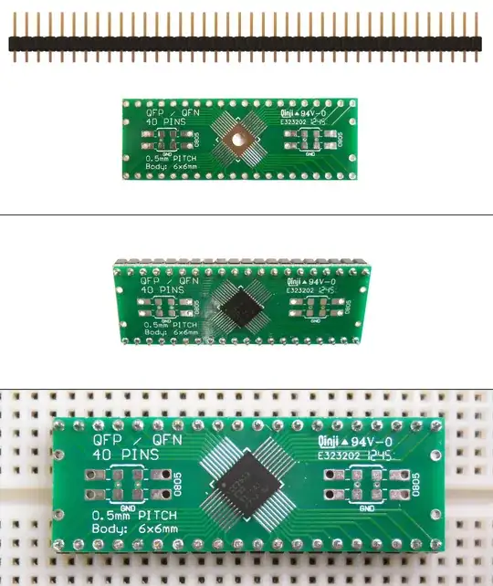

No recommendations on a hot air station but Schmartboard has some great QFN to DIP boards. Here is a video demonstrating how to solder to them.
They have a groove for the chip to sit in while soldering and grooves for each pin so you can run your soldering iron up through each one. I prefer to add some flux and solder and run my iron over each side (solder just falls in to place). They also have a hole in the bottom so that you can solder to the pad on the bottom if it has one.
I have a few and they work fine.
