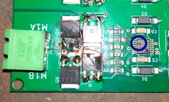

Failure mode pictures: failure on M1 channel failure on M1 channel again

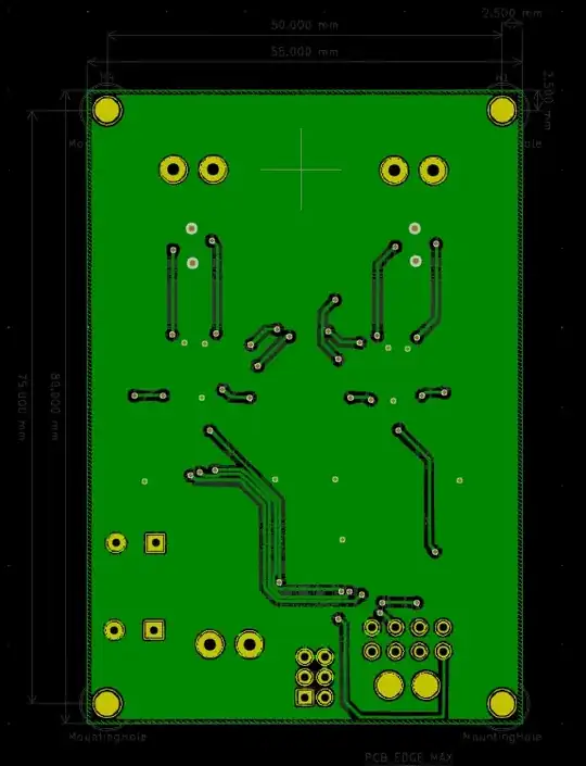

Circuit Layout - 48V distribution to each channel highlighted layout showing the 48V supply going to each channel
Circuit layout - showing H-bridge current paths on both channels. layout and current path arrows
Circuit layout - bottom layer - ground plane also acting as heat sinking surface area bottom ground plane

Failure Modes: 4-5 boards have failed so far, all in M1 channel.
In most situations the M1 channel doesn't fail until the load (motor) is driven by input signals from my control board, which even if they were 100% duty signals should still drive the H-bridge safely and correctly and the motors even have built-in limit switches to shut off when they reach end of travel.
At least 2 have been from power-up and not even actually trying to run the motors, even just powering up is enough to trigger the fault.

Here are some of my observations. One of the first things I noticed is that the PCB layout is not symmetrical, so I looked for differences between the two channels.
The group-of-four traces in the bottom layer (Fig. 1) appear to be of poor quality and very close together with possibly a short circuit. Is this really the case or just a bitmap rendering artefact? Is "signal X" the same as ALO2? You are using suffix "2" for the control signals, e.g. ALO2, but suffix "1" for the motor, i.e. M1A and M1B. Is this correct?
Figure 1 – Annotated circuit layout - bottom layer - ground plane also acting as heat sinking surface area.
Is the 48 V distribution interfering with the signal traces near Channel 1? It appears to cross over the Channel 1 control signals, circled in Fig. 2.
Figure 2 – Annotated circuit layout - 48V distribution to each channel highlighted.
It looks like a high current has passed through the trace and via, damaging the chip at point X, circled in Fig. 1 and Fig 3.
Annotated pin 11 of the MIC4606-2 showing signs of case rupture.
Figure 3 – Annotated pin 11 of the MIC4606-2 showing signs of case rupture.

  • ALO1 signal is the one which shows physical damage on the U1 chip in the image you circled in blue. That's the gate for the lowside FET Q4. See net highlight here: https://ibb.co/LQ64VpY – KyranF Jun 21 '21 at 00:22
