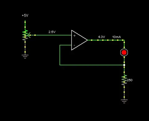

CMOS 4049 inverters have an output resistance around 300 ohms at Vcc=12V so tying then together reduces that to 100 ohms which at 10mA drops 1V so you can use a 13V supply if you like.
If you specify a tolerance on Vout , there are better FETs with much lower resistance.
But this is one solution that can be wired in an IC socket without a PCB. Just add a 0.1uF decoupling cap across 12V to 0V. So use the inverting 4049. enter image description here
When the switch is closed 0V, the 1st stage out is Hi and 2nd stage is low. And visa versa.
