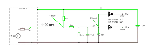

This is the electrical diagram of the sensor and the opotocoupler 4n25.

That sensor has an NPN output. That means, an NPN transistor pulls the output down if the sensor is triggered, otherwise the output is disconnected.
This is your current circuit.
The lowpass filter is between the internal 100k pullup in the Raspberry Pi, and your capacitor. Your resistor actually diminishes the filter effect as it limits the current the NPN transistor can draw from the capacitor. Remove it. If you want to increase the filter effect, add another 1kΩ pullup resistor to +3.3V in parallel to the internal 100kΩ resistor instead. That way the capacitor is recharged quickly after it was discharged by the NPN transistor and spikes cannot trigger the Raspberry input any more.

  • I removed the resistor, added a pull up resistor. and now if I place the sensor 50 cm from the motorcycle chassis no pulses are detected unlike previously. on the other hand if it is closer to the motorcycle chassis or to a steel element it will start to detect several pulses. and when I tried to place a permanent magnet instead of detecting a single pulse it detects almost 10, it is hypersensitive. – mina Jun 15 '21 at 12:50
  • The sparks from the ignition of the bike mess around with all electronics nearby. Put the Raspberry Pi and your circuit in a metal casing that is connected with a conductor to the metal frame of the bike. Likewise, use a metal-fabric sleeve on the sensor cabling and connect it to the frame of the bike. Have your signal wires always stick tight to the ground wires or metal casing. – Janka Jun 15 '21 at 20:30
  • If all that doesn't help, your bike may have the wrong spark plug. There's a high voltage resistor of roughly 5kΩ either in the spark plug or in the spark plug connector. If neither of both has a resistor, the ignition overshoots and creates a lot of irriration in electronics nearby. Check the manual of your bike on whether it needs spark plugs with an internal resistor or not and check the type number of the spark plug actually used. – Janka Jun 15 '21 at 20:38
