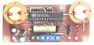

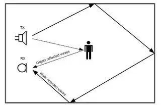

@jcaron's answer mentions Ultrasonic motion detectors and I'll expand on this. They are easy and can be cheap but can see around corners and outside the room; they are not limited to line-of-sight like the PIRs, which can be both good and bad.
An ultrasonic transducer emits an ultrasonic wave (sound at a frequency higher than a human ear can hear) and receives reflections from nearby objects. Exactly as in Doppler radar, heterodyne detection of the received field indicates motion. The detected doppler shift is also at low audio frequencies (for walking speeds) since the ultrasonic wavelength of around a centimeter is similar to the wavelengths used in microwave motion detectors. One potential drawback of ultrasonic sensors is that the sensor can be sensitive to motion in areas where coverage is undesired, for instance, due to reflections of sound waves around corners. Such extended coverage may be desirable for lighting control, where the goal is the detection of any occupancy in an area. But for opening an automatic door, for example, a sensor selective to traffic in the path toward the door is superior.
Cypress Semiconductors Ultrasonic Motion Sensor reference design Cypress Semiconductors Ultrasonic Motion Sensor reference design
