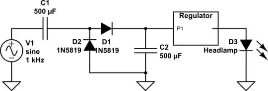

Don't use a bridge rectifier. It's inefficient, because you need two diode drops in series, and it doesn't allow you to use the frame as ground for a DC lamp (like, a modern LED bike light). Instead, consider a voltage doubler
The 'regulator' can be a current regulator, or just a Zener followed by a limit resistor. Several LEDs in series can make use of the 'extra' voltage supplied. Accuracy, like efficiency, is less than important in this application.
I've used a 6V sealed lead-acid battery as the 'regulator'; overcharging seems not to be a problem, and a low-dropout regulator IC can ensure that the output to the lamps is a stable 6V.
Charging from a '5V' source is possible, but depending on such things is less than satisfying; the generator has all the power you need.

  • If you use a voltage doubler without a DC to DC converter you will nearly double your losses in the regulator (such as a 7805). – Voltage Spike Jan 10 '17 at 22:30
  • My original use was with a lead/acid battery, which had such low impedance that the 'doubling' didn't ever effect the output. With larger capacitors, a DC/DC regulator (stepdown) would be more efficient than zener or linear regulation. Smaller capacitors were my limit on battery charge current. – Whit3rd Jan 11 '17 at 06:51
  • +1 for the CircuitLab simulation! (By the way, Falstad is the open source alternative) – JinSnow Jan 14 '20 at 08:17
  • sorry but how do you simulate this circuit? (I clicked on the first link, then on the "simulate" button, it simply opens this panel https://i.imgur.com/gKVnHSO.png ) – J. Does Sep 15 '20 at 13:20
    @J.Does - That 'regulator' is just a placeholder; I used a battery with a voltage regulator in series for an incandescent lamp, but CURRENT, not voltage, regulation is the best way to drive an LED (or multiple LEDs in series). AMC7140 is an example of such a regulator, from China (ADDtek). – Whit3rd Sep 15 '20 at 19:22
  • @Whit3rd I guess I managed to simulate your circuit on Falstad (following your instruction I did replace the 'regulator' with just a Zener followed by a limit resistor) https://tinyurl.com/y47c2pf7 (I did not understand how to use Circuitlab) – J. Does Oct 28 '20 at 14:12
  • @J.Does That diagram shows the zener in SERIES with the lamp, but to regulate, it should be in parallel with the lamp-resistor series combination. The zener doesn't serve a useful function in series, in this application. – Whit3rd Oct 28 '20 at 21:49
