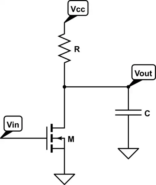

Great Question. As others have stated, the first topology consumes constant power when the output of the inverter is low (logic "0"). Allow me to expand upon this with the MOSFET equivalent. As shown below, the resistor-transistor logic (RTL) inverter has a very similar topology, except for the absence of a resistor on the base (gate in this case, as it is an n-channel MOSFET). Another difference is that there is a capacitance at the output node to GND in this schematic, but that does not affect the answering of the question.
Given the circuit, the same logic applies. If the desired output at Vout is a logic "0", it can be assumed that the input "Vin" is high at a logic "1". This means that the NMOSFET is "on" and current is flowing through it. In this case, the output voltage will fall to 0V (given the capacitance C was previously charged due to a previous "1" output state). Even after the node falls to 0V, there is still a connection between Vcc and GND through the resistor R and MOSFET. Current through the resistor (and the equivalent resistance of the MOSFET) means power dissipation, and this is constant. Thus, this MOSFET version of the RTL inverter also has the same issue.
In the second circuit (the CMOS inverter), "steady state" at the output (either logic "1" or logic "0") means either the PMOS is on and the NMOS off, or the NMOS on and the PMOS off (respectively). In both cases, there is no direct connection between Vcc and GND, so no current at steady state.
