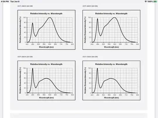

The light from these lights is perceived as a neutral white light because the yellow light stimulates the red and green rods and cones. But for reflected light the absorption of the surface colours renders a product of emmittance and reflectance that we see. The present CRI index uses pastel colours to measure the colour rendering reflectance index which makes Triphosphor fluorescent lamps look favourable to LEDs but the latest 10yr old NIST standard has been slow to be adopted due to industry pressures. This is based on saturated colour rendering which gives tricolour RGB lamps a distinct advantage.
Yet the yellow YAG phosphor over BLUE LEDs continues to yield the highest Lumens per watt efficacy for white light.
Although the CCT depends somewhat on the substrate parabolic reflector cup if used and scattering effects on the phosphor, you can see on the left that as more phosphor energy is increased the Blue energy is decreased and when they are perfectly balanced which was historically difficult, the white appears neutral to the eye. Thus initially LEDs were only warm or cool. But since 15yrs ago, I have been able to source any CCT in the middle range like 4000’K, 4500’K and 5000’K with a tight tolerance on high intensity and Vf at the same time and according to customer requirements. enter image description here enter image description here Samsung LEDs now come in hundreds of bins for CRI 80 or 90 +/-3 with efficacy from 120 to 150 increasing at higher CCT but reduced at higher CRI. But you need to order with a large MOQ if you want special parts.
