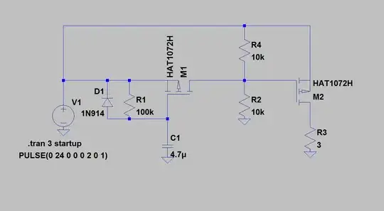

We had a similar question recently. The result is that you need a circuit like this:
You need one of those in each direction.
Whether you use splitters and other cables to connect a four pole Android phone and a three pole (or four pole) PC isn't all that important. The fact of it is, though that you'll need some passive components to make it work properly.
You may or may not need the 2k resistor across the microphone on the PC side. Some recognize the microphone plug mechanically, others electrically.
