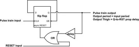

Depending on what you have done here you may get significant shoot-through. You don't want any possibility of overlap between high states for HIN and LIN. Consider using something like this to reduce that unwanted situation: -
Picture taken from here and here.

  • R*C should produce a time constant that covers the potential overlap period. Maybe go for 25 ns - 100 ohms and 220 pF produces an RC time constant of 22 ns. – Andy aka Jun 03 '21 at 12:13
