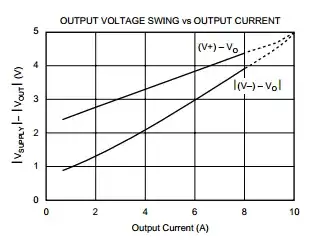

The problem with this circuit is the power dissipated (wasted) as heat. From the OPA549 datasheet : enter image description here
It has horrible output voltage swing to supply voltage characteristics. My R_L is about 1 Ohm. So to drive 5 A, I have to produce a 5V output through the voltage follower. Which means, I have to use at least 8V supply ( to compensate for horrible output voltage swing). 8V is not a standard supply, so I use a 9V supply. And the power dissipated becomes: PD = IL (Vs-Vo) = 5 (9-5) = 20 Watts [Page 11 of the datasheet]. I have tried to find other power amplifiers to replace it. But could not find others that could go up to 5A. I have found rail to rail 2A power amplifiers, but I cannot use that.

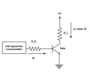

The second method
Use a BJT with a microcontroller :
I basically control the current through the load (iC) by controlling the base current (iB) of the BJT. enter image description here
The problem with this approach is the unreliable beta value in the npn transistors. And I don't know how noisy the signal will be.

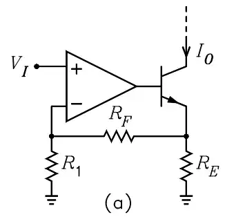

The third method I can use a opamp and a BJT like so:
But it too is highly dependent on that Beta value.

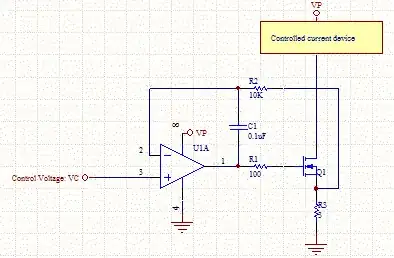

The fourth choice
This is probably the best solution, but I am not very sure and need some opinions. It uses a Opamp and mosfet like so:
The full discussion of this circuit can be found here.It seems to only depend on the resistor R3 (R_L in my case), which I know the value of precisely.

    Your third method is NOT highly dependent on the Beta value. The negative feedback of voltage accross R_E makes Io proportional to Vi (it is still very little dependent of beta because base current also flows through R_E; but this problably can be negelected; using a Darlington transistor would reduce this little effect further). – Curd Feb 01 '13 at 10:30
  • Using Darlington is a good idea, because power transistors don't have good Beta values. But is 5A not too much for Darlingtons? How much power will it dissipate? – Ender Wiggins Feb 01 '13 at 10:45
  • I did some digging around - I take it back, I found Darlington transistors that can handle up to 12 A – Ender Wiggins Feb 01 '13 at 10:54
  • e.g. BDX68: beta > 1000, I_C_max = 25 A, P_diss_max = 200W. "How much power will it dissipate?" only depends on your supply voltage, your load, your R_E and of course I_C. – Curd Feb 01 '13 at 11:13

  • Thanks! That is helpful, I did not know the difference between switched mode power supply and the linear current source. But the real issue with OPA549 is this - My load is 1 Ohm. And it needs 4V to reach 4A. But to get 4V output out of the opamp, I need at least a 6- 7 V source (which is hard to get, so I have to use a 9V). so, P = IE = 4A(9V- 4V) = 20 W. Now, if the OPA549 were rail to rail, I could have used a 5V source and gotten the 4V output easily . so, P = IE = 5A (5V - 4V) = 5 Watts. – Ender Wiggins Feb 01 '13 at 13:31

In the second solution I'm somewhat missing the emitter resistor for the current feedback. I would try something like the second solution, but with the required emitter resistor. Look here: https://en.wikipedia.org/wiki/File:Const_cur_src_111.svg You can adjust the current with the emitter resistor and the base voltage. The discussion of the equation is here https://en.wikipedia.org/wiki/Current_source However, using a a Darlington or arranging two regular transistors to a Darlington is certainly a good idea. And I would start by adjusting the base voltage with a potentiometer.
