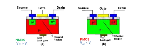

When talking about MOSFETs on an IC, these mostly have a symmetrical structure like this:
Picture from here.
Note how Drain and Source are physically identical.
When using these type of MOSFETs (so when designing a circuit that will be etched on a chip!) then the direction of the current defines which area we call source and which we call drain.
In some situations that direction is unclear (typical example is a "passgate circuit" which is a bidirectional switch), then it is up to the designer to choose which side is the source and which is the drain.
The explanation above does not apply to discrete MOSFETs (and also on-chip High voltage MOSFETs) as these have a non-symmetrical structure. Here's an example of such a Vertical MOSFET:
In such a MOSFET the Drain is constructed such that is can withstand a high voltage and/or it can dissipate a lot of power by mounting the device with the drain side directly on the metal case of the MOSFET and mounting the MOSFET on a heatsink.
