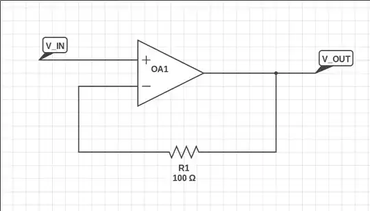

I often see unity-gain followers with a resistor in the feedback path. For an ideal op-amp, of course, there is no current into the input, and this resistor does nothing. What is its effect with a real op-amp, and how do I choose its value?
Unity-Gain follower with feedback resistor
What does R1 do in this circuit?

You will rarely see a circuit with just one resistor as you show it; usually there will be another resistor (or equivalent source resistance) of the same value on the noninverting input, too.
Most (nonideal) opamps have a finite input resistance, and this means that a tiny current flows into or out of the input terminals. This current is called "input bias current", and it varies with the voltage at the inputs. Since most opamp circuits use negative feedback to keep the two inputs at the same voltage, this means that for any given voltage, the current through both inputs will be the same.
The current through each input flows through whatever resistance is connected to that input, and this introduces a voltage shift at the input. If the resistance at the two inputs is different, this voltage shift will be different, too, and the difference between those two shifts will appear as an additional input offset error in the operation of the circuit.
For this reason, an effort is made in all opamp circuits to make sure that the resistances connected to the two inputs are the same, eliminating this additional source of error. Even in a unity-gain buffer, if the source resistance is 100Ω, a 100-Ω resistor will be used in the feedback path.

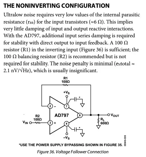

24
Here's an excerpt from the OP27 data sheet, showing that the answer is more involved than equalizing the impedances seen by the two inputs:
OP27 data sheet excerpt
And another example, from the AD797 data sheet:
AD797 data sheet excerpt

    Though the diode protection on the inputs and low Rbb are unusual features of these ultralow noise op-amps, right? If this resistor is necessary it will probably be specified in the datasheet? – endolith Nov 09 '15 at 17:26

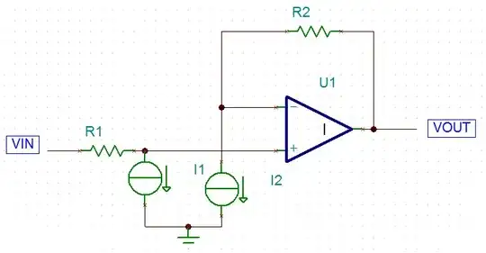

One reason the feedback resistor may be used is to match the output impedance of Vin. Real Op-amps have input current bias and input current offset.
Take for example this representative circuit:
Here, I've create a more realistic model of an op-amp by adding current sources which simulate the current flowing into a real op-amp's terminals. The difference between the two input currents is the offset input current.
The input voltage at the positive input terminal actually is:
\begin{equation} Vin_{actual} = Vin - I_1 \cdot R_1 \end{equation}
Through ideal op-amp action, the negative input terminal voltage is the same. We can then calculate the resultant output voltage:
\begin{equation} Vout = Vin_{actual} + I_2 \cdot R_2\\ Vout = Vin - I_1 \cdot R_1 + I_2 \cdot R_2\\ \end{equation}
By closely matching R1 and R2 the effect of input bias current is effectively nulled. Note that this doesn't solve input offset current, though. To solve both problems ensure that the resistance of R1 and R2 are both small. This will solve both of the issues of input offset current and input bias current. With a small enough R1 there may not be any need for an actual discrete matched R2, though you will of course get better results if there is one.
