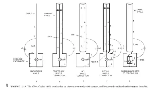

That's also why you need a circumferential connection between your shield layer and the outside of your enclosure. If you use a wire to connect your cable shield to your enclosure, that presents a high impedance path between the shield and noise. From there, the noise currents on the outside of the shield will try to find an easier route and can travel around the end of the shield to the inside where there's a large capacitive coupling between inner shield and signal wire. And if you don't ground the shield, the noise currents will find a way by capacitively coupling to everything around which is probably going to include your signal wire as well as through the air to your enclosure.
Enter image description here
Note the capacitive coupling through the air, as well as the currents travelling on the outside of the shield around the edge of the shield to the inside of the shield. Taken from Electromagnetic Compatibility by Henry Ott.
Check these curves and explanations for different shield constructions: How to Select Cable Shielding for Electromagnetic Compatibility – Part 3

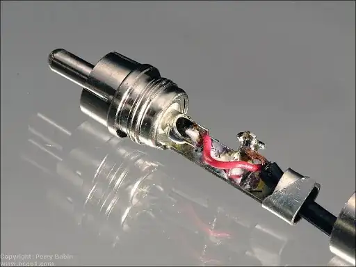

The cheap cable in the video is constructed like this:
There is an insulated wire in the center, loosely wrapped with "shield" copper threads. Since these are not braided, and there is no foil, there are a lot of holes in the "shield". Also copper costs money, so the number of threads is in proportion to the price. Cheaper cable have less shield threads, thus higher shield resistance, and more holes.
The connectors are also cheap and they do not make a coaxial connection: inside the connector's plastic shell, the center conductor is unshielded.
These cheap cables and connectors don't have well controlled impedance, so they're not recommended for HF or video (or anything else really).
