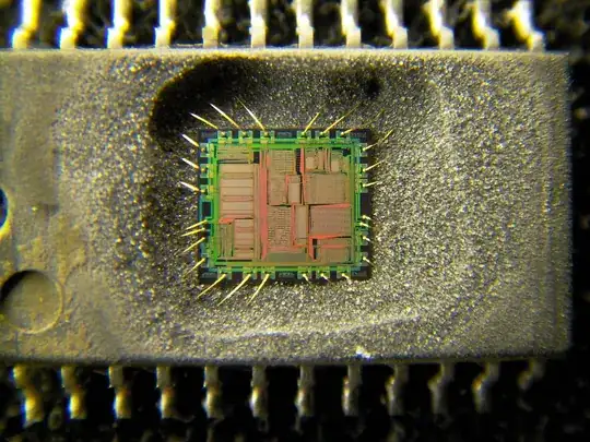

In this microscope image, you can see two wires bonded (attached) to the package in the center.

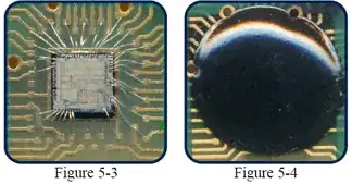

You have probably seen a circuit board for a cheap led screen and it has little black bulge... This is the kind of thing a 'DIE' package is used for. This is referred to as "Chip on Board" as shown below. The left image shows the die directly mounted on the PCB, with the bond wires connected to the copper traces. The right image shows the protective epoxy coating applied after the connections have been made.
Chip on Board
(source: elektroda.net)

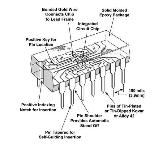

It would be the "Integrated Circuit Chip" in the picture below:
IC internals

    Anyone notice that the DIP schematic image contains the WRONG unit conversion? 100mil = 2.54mm, not 3.9mm as indicated. – DrFriedParts Feb 14 '13 at 17:34
  • @DrFriedParts I think it got transposed from the outside edges of the thicker part of the dip pins. – Passerby Apr 29 '13 at 18:56
