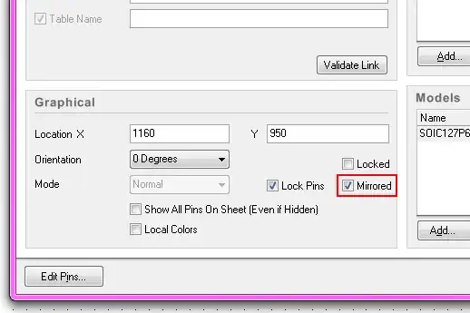

Right-click component -> properties -> check the "Mirror" checkbox (it's in the lower left-ish corner).
To invert, rotate the component 180°, and mirror it.

  • Yes, I noticed this option for single components, however it won't work for a group of components/wires/etc or net labels. – user18482 Jan 31 '13 at 11:47
  • @user18482 - In that case, I think you're out of luck. I haven't found any way to mirror groups of components either. – Connor Wolf Jan 31 '13 at 19:01

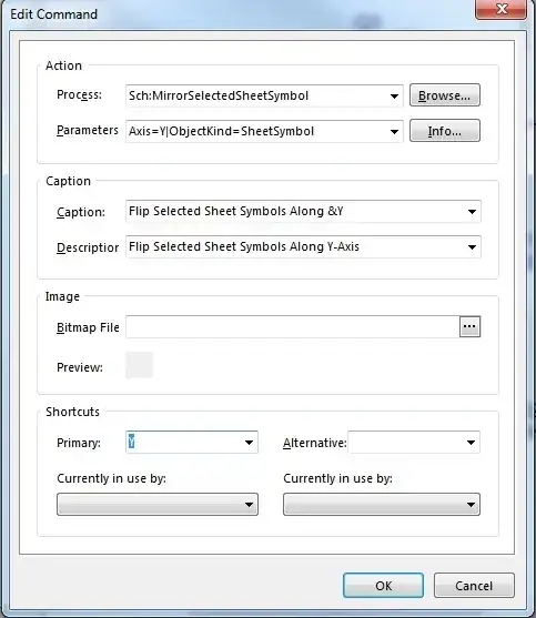

My X and Y shortcuts weren't set and I had a fresh install. Rather than reinstall you can easily edit the shortcut keys by doing the following:
  1. Go to the top menu and navigate to Edit>>Move
  2. hold ctrl and left click the option you want to add a shortcut for.
  3. In the pop up window, you can enter a key in the Shortcuts section. enter image description here
  4. Now you should have access to flip the component via the shortcut key you just set up.
  5. Note: you still need to hold left click on the symbol then flip it.
