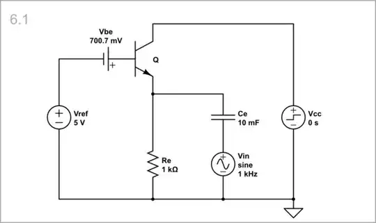

Transistor implementation
First we have to fix the base voltage by connecting a big capacitor Cref to the divider's output. Then, we "raise" the input voltage using a charged capacitor Ce to the 2.5 V level of the emitter and then begin changing Vin. Because of the fixed base voltage, the input voltage variations are directly applied to the base-emitter junction (like in the common-emitter stage above).
simulate this circuit
As a result, an amplified copy of Vin appears across Rc and OUT.

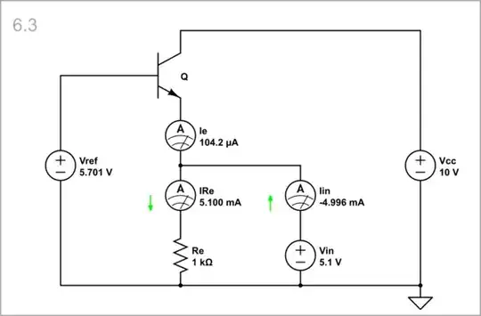

Equivalent circuit. The best way to investigate this is to manually vary the input voltage. To do this, let's replace the capacitor and the AC input voltage source with a varying DC voltage source. Also, let's connect ammeters in the three branches to monitor the currents.
Vin = 5 V: No current flows through the input source as if it is not there. The 1 mA quiescent current flows through the transistor and the emitter resistor.
Vin = 5.1 V: The transistor is almost off. The current through the emitter resistor (almost the same 1 mA) is provided entirely by the input voltage source.
Vin = 4.9 V: The collector current vigorously increases and passes through the input voltage source.
Why is CB circuit non-inverting?
The voltage Vbe is a difference between two voltages - Vb which increases the collector current (common-emitter stage) and Ve which decreases the collector current (common-base stage). If we use the voltage drop across Rc as the output, the common-emitter circuit would be non-inverting and the common-base inverting. But since we are not using the voltage VRc itself, but its complement to Vcc, the circuit operation is inverted and the common-base circuit is non-inverting.
