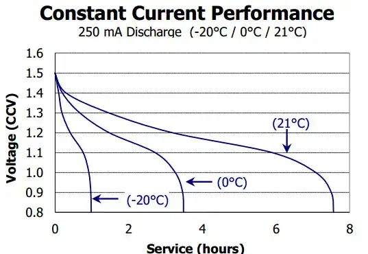

The graph below, from the Energizer E91 AA alkaline cell datasheet, is even more explicit in service life differences:
Energizer E91 service life
Conclusion: It is fair to expect huge differences in service life from a given AA battery under different temperature conditions.
Therefore, it would be useful to examine the battery housing of the device for one part running warmer than the other during normal operation - that would explain the difference, as well as suggest a solution: Switch the batteries around halfway through their expected service lifetime.
