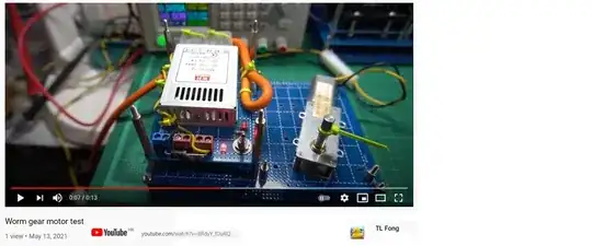

Now I am doing a preliminary test. I used a multimeter to measure the worm gear motor's resistance and found it 28Ω.
So the operating current should be I = V/R = 12V/28Ω ~= 400mA. Then I use a 220VAC to 12VDC 1A PSU to drive the motor.
I found the motor moving slowly, as expected: youtu.be/8RdyY_lDuRQ.
worm gear motor test
