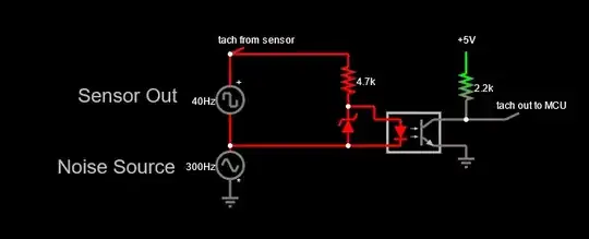

There's an additional benefit to using an optoisolator: by referring the diode input to the sensor ground, it will reject common-mode noise that might find its way onto the sensor wires.

MORE: Here's a simulation of common-mode noise with the optoisolator (try it here). I added a Zener to protect the opto LED, it's optional.

  • I used an optoisolator, is the best choice, fast and reliable. Thanks for your help! – Enzo May 14 '21 at 21:58
