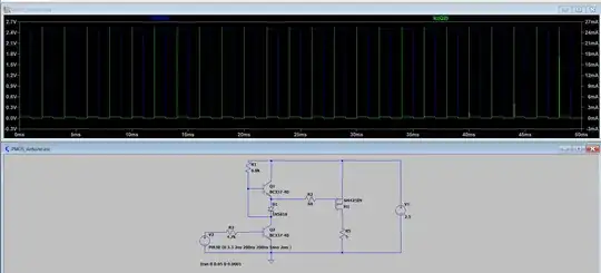

Simulation SPICE (transistor not equal, because it is not in the default list) Vcc=2.5V. You can see the current of Q2 is just a spike of cca. 30mA, this is the MOSFET gate discharge current. Voltage on load is full Vcc.
Vcc=4.2V. Green - Q2 current spikes at 45mA; Blue - Q1 current spikes at 25mA/ gate charging current; Red - load voltage.
