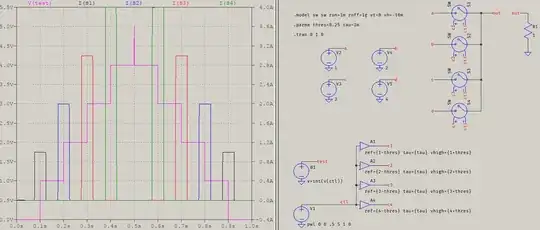

I need to implement what I will describe as a power multiplexer for use in testing other circuits in LTSpice.
The idea is to be able to switch a range of loads and sources into the output of the circuit I am working on. For example, I might want to test with a pure 100K resistive load, pure 1K resistive load, 10uF capacitive load, 1A current source (load or source, depending on how you look at it), inductive load, short to ground, short to V+, etc.
Imagine a bank of physical switches connected to the UUT. You use this bank of switches to see how it reacts to being connected to a range of circuits/loads/sources/sinks.
I also want to keep it simple, in the sense that it should create minimal simulation load.
Finally, rather than control it digitally, I want to control channel selection using a voltage. This allows for using PWL ramps or stairsteps and automating the testing with all available loads and sources.
Here's what I've come-up with. It works. Can it be improved?
LTSpice Power Multiplexer
Only showing a few channels in the image, here's the entire model (includes extra hardware for testing):

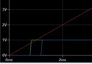

The output looks like this:
LTSpice power multiplexer output
One of the aspects that is different from the real-life bank of switches concept is that LTSpice doesn't like not having a load on a SW element. Hence the 10K resistors and the 1Meg resistor on the output. I would remove the latter when turning this into a component as I don't think it would be necessary for real application.
EDIT1: The intent was to turn this into a subcircuit that could be used anywhere, which is precisely what I did. Here it is in its application form:
EDIT2: I thought it would be good to add an explanation of how this circuit works just in case it might be useful to others.
Each channel has two threshold detectors in the form of switches. Their operating parameters are set in the model statement. Of interest are the thresholds. I use variables to set them up. Each channel has a low and high threshold detector. In the case of the first channel, TH1_L triggers at 0.8V and TH1_H at 1.2V. The channel output switch is driven by these two detectors, which means the channel turns on when TH1_L=1 and TH1_H=0. Here's a closeup of the action around 1 V using a ramp as an input (red). TH1_L is green and TH1_H is blue:
What I like about this is that the channel active zone is nicely centered around 1 V. This approach also avoids cross-conduction between channels. Here's the output showing all channels. In this case I applied a different voltage to each channel input in order to be able to visualize what's going on. The first channel starts at 0.75V and each succeeding channel is 1V higher. You can clearly see there's no cross-conduction zone and we can tell exactly which channel is on in this test. We can also see what happens in out of range conditions.

That said, here's another version of what (I think) you're trying to achieve. It's bidirectional, despite what the picture shows:
test
As it is, the voltage at the control pin, V(ctl), selects an input based on the equivalent of int(): if int(V(ctl))==1 then it connects the first input (maybe I should have labeled them 1, 2, 3, 4, instead of a, b, c, d) with out, if int(V(ctl))==2 then it connects b <-> out, etc (see V(test) for comparison, its only purpose in the schematic). Anything outside the range means all switches are off.
In your schematic, you're using the switches without vh specified. That defaults to 0, which means an abrupt switching around the transition. You should know that there are very good reasons not to choose that behaviour (read this, for example). Because of this I have added vh=-0.5 (also be sure to read the manual under LTspice > Circuit Elements > S. ..., especially the part right beneath the first table). To make use in full of this smooth switching, you should also add tau=<value> to the buffers. This way you can eliminate cross-conduction, except for an insignificant portion. For a more pronounced effect, set vt higher and vh=vt-1. Here's how it looks with tau=1m for the buffers and vt={x} vh={x-1} for a .step param x 0.5 0.9 0.1:
cc
There may be cases where an abrupt switching is needed, for example to see the behaviour of a resonant tank, but, in general, a non-negative vh will work in simple cases like this, but when involved in more comples ones, particularly in feedback systems, it can be a cause for "timestep too small" errors.
Your choice for Ron and Roff is a very good one: the values won't influence the output that much while keeping the dynamic range of 1e12 or less. In case you need heavier loads, you could tweak it to be (e.g.) Ron=10u Roff=10meg, but don't forget about the negative vh.
Not lastly, all this can be encapsulated in a subcircuit with an appropriate symbol, see this excellent answer on how to do it. The only needed parts are the buffers, A[1:n], and the switches, S[1:n] (and the .model card), while the nodes are a, b, c, ..., n, out, and ctl. You may add a 1g resistor to ground inside the circuit, for those cases where the ctl pin might be floating, somehow (the simulation might abort with an error). As I said, it's bidirectional, so out is not such a good choice for a label.
There is a reason why you got an error without a resistor. Referring to your last picture, you tried to feed V2 through S6 straight into S8's input, but VCSWs are pure voltage mode: their inputs don't consume current, and current monitoring is disabled for this reason -- just try to feed a voltage source straight into a pin of a VCSW and try to plot the current through the wire (not through the source). Therefore S6, without R2, has no effect, but with it, it can act as a controlled voltage divider.
Also because of the pure voltage mode, leaving any control input floating may result in a "singular matrix" error, since it is expected that the pin must have a potential, of any kind. It might work, it might not, but to be safe the only cure is to add something, anything, even a capacitor.
Regarding your comments and recent edits, if you need the switches to have a larger window, then you can add another batch of buffers to help. Plotted against int(V(ctl)) you can see that they turn on/off symmetrically around the transitions:
gapped
This can be added as a parameter, here thres, for better control. Of course, the values don't need to be 1±thres, 2±thres, etc, they can be any other: 3.14±thres, 1.618±thres, ... In fact, thres doesn't even need to be symmetrical around the value, you can always add thres1 and thres2. You can also make the thresholds overlap, you'll see nice cross-conduction. Here's the source for the .asc file:

If you know the controlling voltage doesn't dally too long in the transition regions, half of the buffers can be eliminated. I'm not sure it can be simplified further (but I'd love to be proven wrong). The changes are in the addition of vhigh for the buffers, and a modification for vt and vh for the switches:

SYMATTR InstName A3
SYMBOL Digital\\buf1 208 288 R0
WINDOW 3 20 90 Left 2
WINDOW 0 42 46 Left 2
SYMATTR Value ref={4-thres} tau={tau} vhigh={4+thres}
SYMATTR InstName A4
TEXT -64 -344 Left 2 !.tran 0 1 0
TEXT -64 -424 Left 2 !.model sw sw ron=1m roff=1g vt=0 vh=-10m
