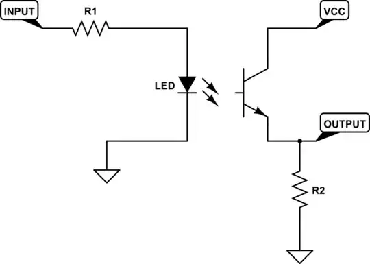

Please see this diagram:
balun
On the left is a fairly typical unbalanced to balanced circuit featuring 2 opamps.
The signal is then passed over a shielded twisted pair.
On the right, I want to use a transformer to both 'unbalance' the audio and to isolate it.
Is this possible?
All diagrams I've seen show transformers with a centre tapped primary used to unbalance audio,but that means I have to connect the centre tap to the ground of the left hand circuit.
This is only one channel. I want to use a cat6 cable to transmit and receive 3 isolated audio channels, o I can't use the shield as a ground for all three channels because they wouldn't be isolated.
  • Do I need the ground from the left hand circuit at all? Can't I just use a transformer with a single primary and secondary? That is, not have any reference to the ground of the left hand circuit at all, in the right hand circuit?
  • I remember reading somewhere that connecting ground to chassis at both ends of a long run can cause noise. People suggest not connecting the cable shield to chassis at one end of the cable run. Is this nonsense?

I want to use a transformer to both 'unbalance' the audio and to isolate it. Is this possible?
Yes.
All diagrams I've seen show transformers with a centre tapped primary used to unbalance audio. But that means I have to connect the centre tap to the ground of the left hand circuit.
Because you want galvanic isolation, the center tap of the transformer should be connected to the ground of the transmitter, rather than the receiver. This means your cable should have a third conductor, a "signal ground" along with your differential twisted pair.
An alternative topology is to put the galvanic isolation on the transmitter side.
For the receiver to be balanced (which is necessary for the twisted pair to be balanced) the values of Rhot and Rcold should be equal, and likewise, the values of Rf and Rg. The resistors should be 1% precision or better, for good "balance" and (common mode) noise rejection.
If the cable is not too long, (and the frequency is audio, as it is in this question), it is not necessary to match the receiver's impedances with the characteristic impedance of the cable. However, if the cable is long, (or the frequency is above audio, which it is not in this question), then the receiver's impedances should match the characteristic impedance of the cable. To do so, the resistor values should all have a value equal to 1/2 of the cable's characteristic impedance. For Cat-5 or Cat-6, this would be 50\$\Omega\$.
The twisted pair is balanced according to the definitions given in Wikipedia and this stack exchange answer. That is, the impedance from either line to ground is the same. By having the impedance to ground in both lines the same, common mode noise (such as "hum") that is picked up on the line can be rejected by the receiver's differential amplifier.
[The twisted pair is NOT "balanced" according to some (misguided) criteria. That is, it is not +6dB higher than the original signal. Nor can you double the voltage by shorting one of the lines to ground. This are commonly tests for "balance", but are, in fact unrelated to "balance"]
My second question is. I remember reading somewhere that connecting ground to chassis at both ends of a long run can cause noise. People suggest not connecting the cable shield to chassis at one end of the cable run. Is this nonsense?
No, it is NOT non-sense. The "people" you refer to are correct. Connecting a shield to ground at both ends creates a ground loop. Ground-loops can induce noise into your signal. Don't connect the shield to ground on two sides, just one.

  • Thank you very much for this answer. In your diagram, is the signal on the twisted pair balanced? In the same way it is in the RS485 topology? My issue is really cost. Good audio grade transformers cost upwards of £30 each. Also they're huge. I went with an 'active' system on one side to reduce cost and size. Does the system in your diagram require two transformers in order to work? Or can one side be replaced with some sort of active system. Afterall we only need one transformer to achieve isolation. – Richard Apr 30 '21 at 08:56
  • @Richard I modified the answer to give an alternative way to get galvanic isolation with a single transformer and a single twisted pair, which is balanced, by putting the isolation transformer on the transmitter side, rather than the receiver side. It also significantly simplifies the transmitter. – Math Keeps Me Busy Apr 30 '21 at 12:28
  • This is really a thorough, clear and useful answer to my specific question thank you very much for your time and effort. There's a lot to digest here. But I think I can go ahead with my rough original Idea once I've understood what you've said properly. Very pleased. – Richard May 01 '21 at 00:23
