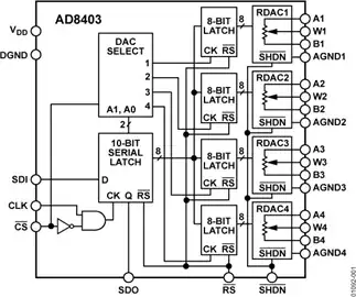

Yes, there are. Usually, in the literature, they are called Digital Potentiometers (DigiPOT).
One of the most popular one (and my personal favorite) is AD8403. It is up to 100 kΩ controlled by 3-Wire SPI-Compatible Serial Data Input with 256-bit register.
But you can find much more options to chose from here
