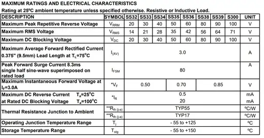

chosen mosfet
chosen diode - SS34

PS. It would be good to have a link to the datasheet within the question and the Maximum rating section that you quoted is not very useful for design purposes, it is mainly for showing the survival limits of the device.
I have included a link to the datasheet here Datasheet
