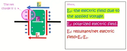

The transformer core once voltage is applied one side will have +ve charges and -ve charges on the other side as shown on the first figure. This separation of charges by the applied voltage will cause the core to become polarized (positive charges will be separated from negative charges inside the core). So, as the second figure shows the core positive charges will be attracted to the applied voltage negative charges (opposite charges attract each other) and the core negative charges will be displaced towards the applied voltage positive charges. Thus the core will produce its own field E1 which opposes the applied electric field E0. E1 is what produces the back EMF. So, the resultant field, E will be less than E0, But, in the same direction. The opposing electric field slows down the change of current.
Back EMF changes instantly but the induced current in the core can't change instantly since the current is di/dt (dt≠0).
the back EMF is proportional to the amount of change of the current, the larger the current changes the larger the EMF is.
EMFs can be generated in a wire in three different ways: by moving the wire (motional EMF), by moving a magnet near the wire, or by changing a current in a nearby wire.
As it has a voltage opposite to the applied one, so, it goes back into the source to oppose the current thus the name back EMF.
Am I correct?

    **1)** Are two images edited by you ? please add a link to the unedited images from the original source. Use the [edit] link below the question to do that. **2)** One image is that of a transformer and another seems to be a capacitor ? This will lead to confusion. Restrict your question to either the transformer or a capacitor. – AJN Apr 27 '21 at 12:26
  • There are a number of items confused in your post. You are showing an open-circuit on the secondary so there will be no current flow in it and it won't affect the flux. I can't see the relevance of the capacitor diagram. – Transistor Apr 27 '21 at 14:12
  • I think you are taking the blue arrows in the core drawing to buy electric current. It's not. It's magnetic flux. Current in the coils induces flux; changing flux induces voltage (EMF). In the driven coil, this voltage resists the change in current. Hence, back EMF. – TimWescott Apr 27 '21 at 14:18

This question contains a new mixture of misconceptions.
You should remember that induction happens in space where magnetic field changes for any reason. In transformers the magnetic field occurs mostly in the iron core as you have drawn. That's the peculiar quantum physics effect (ferro- and ferrimagnetisms) how external magnetic field caused by current in wires succeeds to persuade the molecular magnets to take the same magnetic field direction as the external field. Thermal random motion tries to disturb it, but in normal core materials the magnetic flux is easily hundreds of times stronger than the same windings and current would cause in free air.
Essentially Faraday noticed that changing magnetic flux in the core generates immediately (=at the same time as the change occurs) a new field which is in the same space as the magnetic field and around it, but directed differently. It's the induced electric field. It does not diverge outwards from charges, it exists as closed loops around the growing or weakening magnetic flux lines.
In transformers the induced electric field is circularly around the core just like the turns of the windings. It pulls electrons along the wire so that a substantial voltage can occur between the ends of a winding. +pole is that end where electrons are pulled from and -pole is where the electrons accumulate to.
The circular field electric field is also inside the core. That's why the core of the transformer should not be conductive. It can be made of ferrite which is an insulator. Iron sheet cores are divided by thin insulation layers to separated small areas so that no circular (=eddy) current can exist around the core. Eddy current would affect like a shorted one turn winding.
Faraday noticed that the induced voltage between the ends of a winding is proportional to the changing speed of the magnetic flux. At the same time (with no idea what Faraday tinkers) Joseph Henry invented that induction happens also in a single coil if the current in the coil changes. That's a special case, where the cause of the change of the magnetic flux is a growing or decreasing current.
The back EMF is a thinking model of that phenomena. Many of us who work with circuits think that there's an internal controlled voltage source in an inductor. The source voltage follows equation V=L(di/dt) where the proportionality factor L is called inductance and di/dt is the changing rate of the current. Many of us insert minus sign in front of the L(di/dt) because they have bolted themselves to think there should be some indication for the fact that the internal voltage source has the polarity which resists changes of current.
I do not need that internal voltage source to stay calm. It's enough that the voltage between the ends of an ideal inductor is L(di/dt). Resistance or other non-idealities can be modeled by inserting additional parts and another inductor which is so near that its magnetic flux substantially intersects the first inductor can be taken into the account with mutual inductance.
Your capacitor analogy is nonsense. In capacitor the electric field is between the charged plates. The field starts from +plate and ends to the -plate.
The induced electric field which can be seen as voltage between the ends of a winding is circular around the core like the wire turns are - the field has no start nor end points. But to stay in truth I must add, that there happens in capacitors something which is analog with the induced electric field in inductors. See in the end part "Maxwell's own invention"

Comments on your question:
Question Response
So, as the second figure shows the core positive charges will be attracted ... No, that image is irrelevant as it is about capacitors, not inductors.
Thus the core will produce its own field E1 which opposes the applied electric field E0. E1 is what produces the back EMF. No, there is only one flux (not a field) in the core. It's the same one that's induced and that causes the back EMF.
Back EMF changes instantly but the induced current in the core can't change instantly ... There is no current in the core. There is magnetic flux.
The back EMF is proportional to the amount of change of the current, the larger the current changes the larger the EMF is. The back EMF is proportional to the change of flux with respect to time. (That's the \$ \frac {\Delta B}{\Delta t} \$ refers to in Figure 1.)
EMFs can be generated in a wire in three different ways: by moving the wire (motional EMF), by moving a magnet near the wire, or by changing a current in a nearby wire. None of these are really relevant to your main question.
As it has a voltage opposite to the applied one, so, it goes back into the source to oppose the current thus the name back EMF. Close, but a bit garbled maybe. The sign of the back EMF is such that it subtracts from the applied EMF (the primary voltage). The effect is that the driving voltage appears to be lower than it actually is and therefore less current flows than the DC resistance would suggest.
