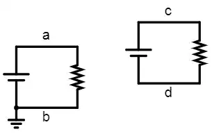

However, when there are multiple voltage sources, some of them are "floating". What meaning does the voltage of a floating voltage source have?
If I have voltage source with value V between nodes a and b, it means that the voltage difference between a and b will be V volts. A perfect voltage source will generate whatever current is required to make this happen. If one of the nodes happens to be ground, that gives you immediately the value at the other node in your reference system. If neither of those nodes happens to be "ground" then you will need some other connections to establish the value of the voltages at a and b relative to ground.

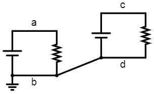

Consider two super simple circuits (one voltage source in series/parallel with a resistor, for each circuit), which are conductively isolated from each other (i.e. there are no wires connecting any nodes between them). Suppose you choose the node of the negative terminal of the voltage source of one of the circuits as reference node (read definition #1), as shown in the following figure. Then, it is impossible to determine the nodal voltages of the other circuit. You or a circuit simulator wouldn't be able to solve the equations for the nodal voltages, because there wouldn't be any known equations relating the voltages or currents between both circuits.
To solve this problem, you could connect the node of the negative terminal of the voltage source of the second circuit to that of the first circuit, as shown in the following figure.
