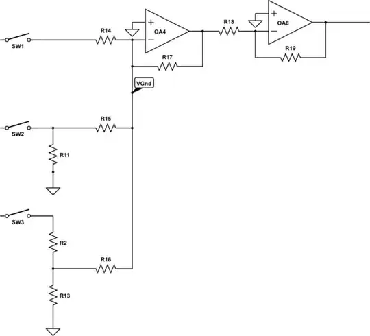

I want to use a rotary switch to switch between filters which I believe will give me different frequencies. But the problem is when I connect the positive feedback to the other filters too, naturally, the circuit changes. So to prevent this, I want to use the rotary switch to switch between filters and when I switch, I need another switch to connect the switched filter to the positive feedback. Below there is a manual, inefficient try. I painted the focus point with yellow.

I want to build a wave generator. I chose wien bridge oscillator(WBO) as my oscillator and I obtain other waveforms by filtering the sine wave I get from WBO. I managed to get a fairly decent wave forms when the switch is at position 1 but nothing near that other combinations. I am looking for ways to improve my design and make it work since it doesnt work as intended.

Design and Circuitry Explanation
Circuit
I power all the opAmps with 15/-15 volts
I used:
  • TL071 OpAmp
  • 2 x 1nF capacitors
  • 3 x 100k resistors
  • 1 x 210k resistor
  • 2 x back to back diodes
To build the oscillator. I get a nice sine wave with this setup, which is actually one of the reasons I chose WOS. Even though the signal was clear, the magnitude of output was pretty low (around 750mV) and I wanted to amplify it.
I used:
  • UA741 OpAmp
  • 1 x 100k resistor
  • 1 x 10k resistor
To build an amplifying component with gain 10. Now my sine wave was nice and around acceptable magnitudes. Then I wanted to filter and amplify it again by using an integrator OpAmp to gain a square wave.
I used:
  • TL071
  • 1 x 1k resistor
  • 1 x 1nF capacitor
I preffered TL071 here again to get rid of the slope of the square wave. TL071 has a higher slew rate around 10V/us as I remember. As you will see the square wave is pretty neat too.
To acquire the triangle wave I used the same circuitry I used to filter the sine wave. At first I tried to use an UA741 but it just gave me the same square wave, I dont know why. Later I just used a low pass filter
using
  • 1m resistor
  • 1nF capacitor
which gave me a rough triangle wave it had peak voltage near to none. So I used TL071 instead of UA741 to apply the same filter I used on sine wave, to the square wave. This gave me a decent triangle wave with a little plateau.
outputs with oscillator having 1nF capacitors and 100k ohm resistors
In the end, I had a nice sine wave (around 6.5/-6.5 peak voltage), a nice square wave (around 12.5/-12.5 peak voltage) and an acceptable triangle wave (around 12.5/-12.5 peak voltage). To implement the adjustable output peak voltage I thought about using a potentiometer to change the gain of first OpAmp which amplifies the sine wave. To implement the adjustable frequency I thought about putting some capacitors with trimmers. Since for the sake of oscillation C2 should be equal to C1 and I couldnt find a way to change both capacitance exactly the same (like a ganged up potentiometer) while adjusting the frequency, so I abandoned this idea.
I thought maybe using a rotary switch I can switch between frequency mods, which turned out to be a huge dissapointment. In the schematic above you can see the final implementation. when switch is at first position everything is fine. As I switch problem begins.
after switch graphic
You can see the switch time exactly. Plot of before and after the switch
Close up
Close up
There were even times that I get 0 output from every wave form. I need suggestions to:
  • Implement adjustable voltage and frequency
  • Fix the plateau at triangle wave
  • Any opportunity for improvement you see
Thank you.

  • We don't have any clue what kind of switches you have and how they work. Based on your question, we could simply ask you to glue them together. To get better responses, please give out as much info you possibly can. – Justme Apr 24 '21 at 19:40
  • Perhaps you could use a relay for one of the switches. But please clarify your problem with as much detail as possible. – Math Keeps Me Busy Apr 24 '21 at 19:43
  • In many types of switch there are switches that have multiple poles. For just opening and closing two switches simultaneously you need an double-pole ( or 2-pole), single throw switch. –  Apr 24 '21 at 19:52
  • I am trying to build a project and asked a question about it already but ı cant get enough responses on that thread so ı asked this one. If its ok with the site rules ı can share the link where ı explained the problem very detailed. – Tombeki Apr 24 '21 at 20:14
    The reason you are not getting responses is because your questions are so poor. There is no useful information in your question. Is the circuit AC or DC? Is this for low power signals or high-power devices? Is this school work? – AnalogKid Apr 24 '21 at 20:24
    Sharing links is fine but on this site there should be enough information in the question so that we can answer it without following links. You can paste the other information in here using the [edit] link. – Transistor Apr 24 '21 at 20:28
  • I edited the question with detailed explanation. I asked different questions but gave the same detailed information. – Tombeki Apr 24 '21 at 21:01
  • Could you explain how you generated a square wave from a sine wave by using an integrator? Integration of a sine wave produces another sine wave. You need a non-linear device to change a sine wave into a square wave. – Barry Apr 24 '21 at 22:59
  • @Barry I really dont know the math yet, ı know its trivial the integral of sine is another sine yet it works. I think it is explained using fourier series which I dont know any knowledge about yet. – Tombeki Apr 25 '21 at 06:44
You should use a 2 pole rotary switch, also known as a ganged switch.
RV1 should also be a ganged type.
http://www.audiomaintenance.com/acatalog/EL-03-014_extended_info.html
Mattman944
  • 13,638
  • 43
  • I think im gonna go with it, thank you again Mattman. Your circuit is actually different from mine, with no negative feedback but I think its because you just wanted to show me the ganged rotary and ganged pot configuration is it correct? Also is ganged up pot for fine tunement or increasing the output? Because as far as I know back to back diodes really clamp the output voltage so increasing gain is not working. Thats why ı used another opAmp to amplify the sine wave. I thought I can use a pot on its gain resistor to tune the voltage, what do you think? – Tombeki Apr 25 '21 at 06:29
  • I didn't draw the negative feedback, if the oscillator is working, don't change it. Adjusting the voltage output amplitude by changing the feedback circuit is not a good idea. This is a finicky circuit, get it to oscillate reliably, add gain in another stage. Yes, the ganged pot is for fine frequency adjustment. – Mattman944 Apr 25 '21 at 06:39
