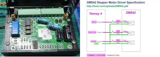

  1. There are many possible causes of trouble. I opened the DM542 module coveer and found three optocouplers EL817c and current limiting resistors 270Ω. One cause is on the input side of the DM542. The three EL817C each needs 5mA to 20mA to enable/trigger. The 20mA current can be from a common cathode source driver, or common anode sink driver.
dm542 optocoupler driver

Appendix B - DM542 HCT125 3V3 to 5V0 Common Cathode Wiring
Appendix C - DM542 Setting up and Troubleshooting Check List
Appendix A - Microstepper Configuration Settings
config 1
Appendix B - Wiring Diagram for HCT125 Common Cathode Configuration
common cathode wiring
