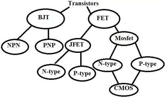

Searching the internet doesn't yield much other than a few transistor family trees and the like:
Transistor Types
from Learning About Electronics
Does anyone know of (or wish to create!) a useful transistor selection guide that doesn't assume you are familiar with all the species of transistor?

    I think that diagram is brain-damaged. For starters, CMOS isn't a kind of transistors, but rather an arrangement of distinct N-channel and P-channel MOSFETS. There are also transistors that don't fit in this hierarchy, like IGBTs. – Phil Frost Jan 25 '13 at 19:16
  • @Phil I sort of wanted a "brain-damaged" chart to illustrate the need for a better one. I think there exists a great opportunity for a clear transistor infographic. – JYelton Jan 25 '13 at 20:42
