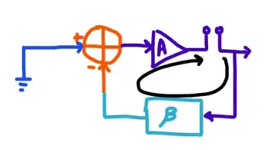

Ultimately, you can view the circuit in front of you as a feedback system. Feedback systems are common and well-understood in electrical engineering -- examples include something as simple as an op-amp amplifier. Generally, we like them to be stable, but oscillators are an example of a feedback network which is intentionally unstable.
In order to discuss how an oscillator can sustain an oscillation, we should start by looking at a stable feedback network first. Here's the stereotypical closed-loop feedback structure, along with an example realization of one. The colors are used to mark corresponding portions of the feedback structure and the example realization I show here.
Let's look at the so-called "loop gain" of the structure. To do this, we null the input, and we break the loop at any point. We then inject a signal, let it make a trip around the loop, and see what we get after it goes around once1:
In an ideal world, the loop gain is negative. However, the loop gain is actually dependent on frequency. Under a typical assumption that the circuit is linear and time-invariant, we can consider its response to every frequency of sine wave independently. For each sine wave you put in, you get a sine wave out at the same frequency. This assumption holds really well for small signals, while for larger signals the amplifier may saturate (not necessarily by saturating any individual transistor).
The loop gain is then a function of frequency, and is composed of both a magnitude (how big the output sine wave is, compared to the size of the input sine wave) and phase (how much the output wave is shifted) compared to the input wave. The loop gain tells us all about how our system responds to a sine wave going around the loop, including whether it grows or shrinks. In the definition of loop gain, I consider subtraction a part of it (since it's both in line with the tools I use, and it is conceptually simpler to think about since there's no "double negative" to keep track of at oscillation).
A sine wave that grows (magnitude > 1) while keeping its exact phase (loopgain phase is zero degrees) is going to become an oscillation, and if there's any such frequency at which the amplifier has a loop gain of zero phase, gain > 1, the system will oscillate at that frequency.
Going back to our ideal world where we want a stable amplifier that doesn't oscillate, we want it to have a loop gain whose phase is 180 degrees -- when we put a sine wave deviation into the loop, the amplifier corrects it.
We can plot the gain and the phase using a so-called Bode Plot:
Notice the orange marker and how it indicates an important characteristic of the amplifier circuit: By the point the phase reaches zero degrees (meaning that you put a sine in and it comes out at the exact same phase), the gain is below 0 dB (meaning that the oscillation dies out). This amplifier is stable.
